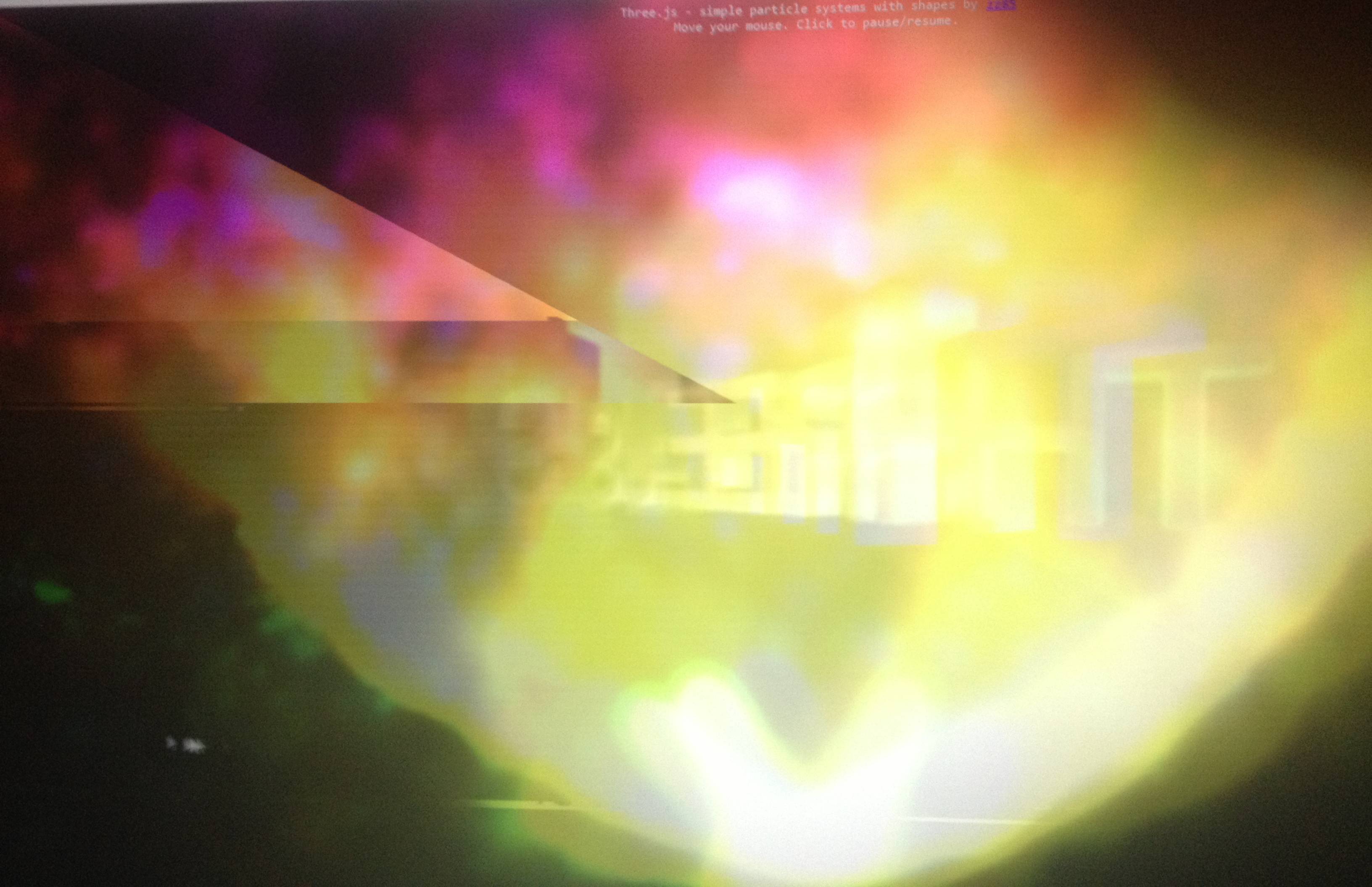

The tearing starts top left like this

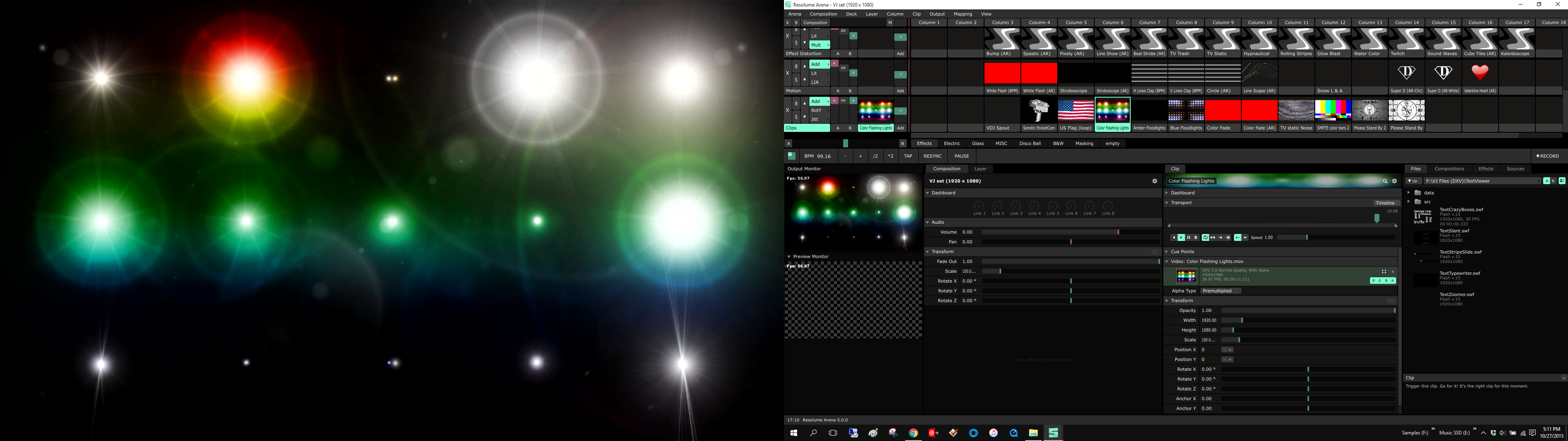

The clip has to change very quickly. Here is my setup

I have the exact same problem after updating to windows10 - diagonal screen tearing. It also happens in other programs like Firefox, even on simple text+img webpages (tho not as strong), which to me proves this is not a codec problem, rather something Windows or Nvidia related.
Running a Geforce GT 750M in a Dell XPS 15 (2014 model). Using internal graphics prevents screen tearing.
