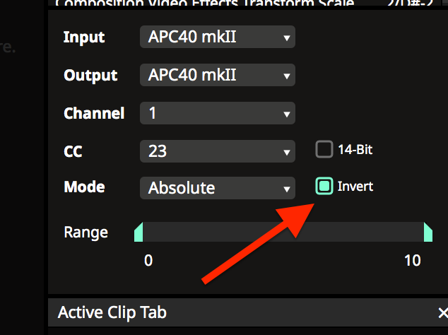

Doesn't this do what you'd like?

Unfortunately the option isn't there for me since I'm using the CC as a button. Could you add the Invert option to Button Mode (Non Piano Button Mode)?

Hmm, not sure if you want to invert the feedback only or also the reaction in Resolume to the CC?

I'm using a controller that has it's buttons mapped to CC's, so in this case I would like to have the LED ON when an FX is NOT bypassed (to let me know it's on). So just a way to invert the outgoing MIDI message would be nice (Same as MIDI notes).

Hmm, for notes the buttons also will work backwards if you invert.

Correct, but these button are CC's and not notes. So I can either invert the LED signal in Bomes or convert the CC to notes in Bome. I'm just trying to not have to use Bomes and see if this would be possible to add in Arena at some point?

Not sure,
How would you invert a CC value of 23?
Make it 127-23?
What if it's a dial, and it changed from 24 to 23, should it output 25?
