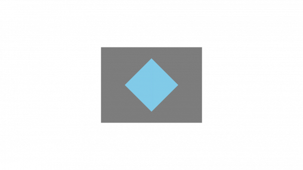

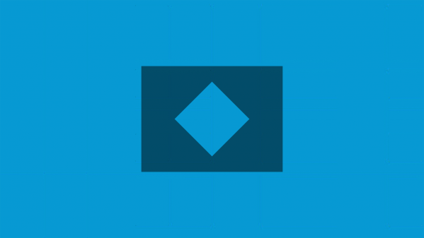

That would mean that using the same two files, if I adjust the opacity of the mutiplied clip to 50%, I would get the following result (which is what I get in both Adobe Photoshop and Dataton Watchout):

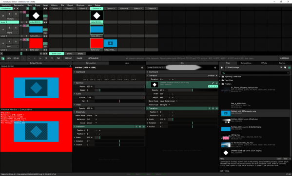

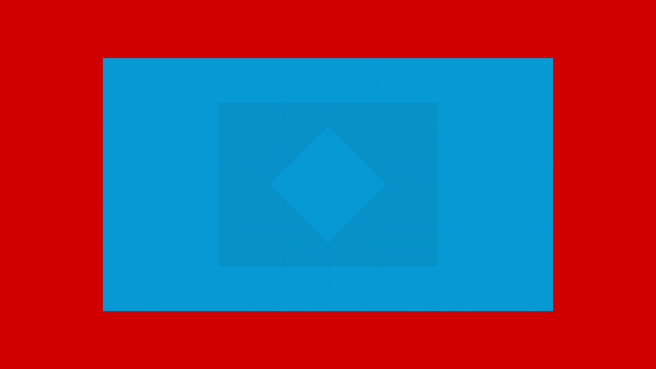

instead of:

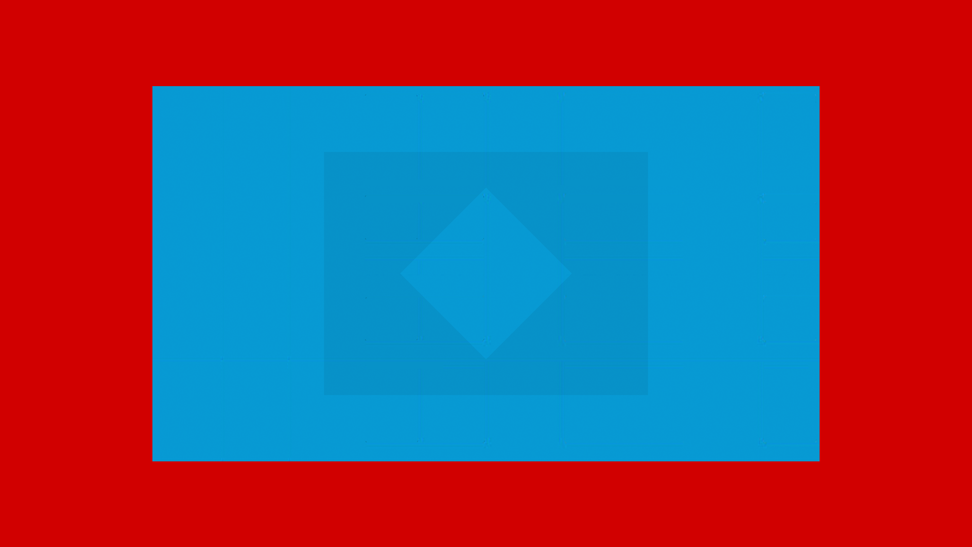

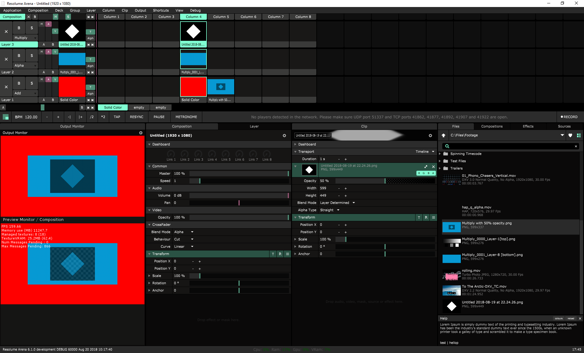

And at 5% clip opacity I would get this:
All that being said, the ability to multiply with just alpha where a=1 create full transparency on top of any color and a=0.5 create 50% transparency would be a great effect on its own especially with groups!

Re: Arena 6 multiply blend mode fade problem
If you haven't yet, take a look at this thread and download 6.1.0 which has the corrected multiply blend mode.
