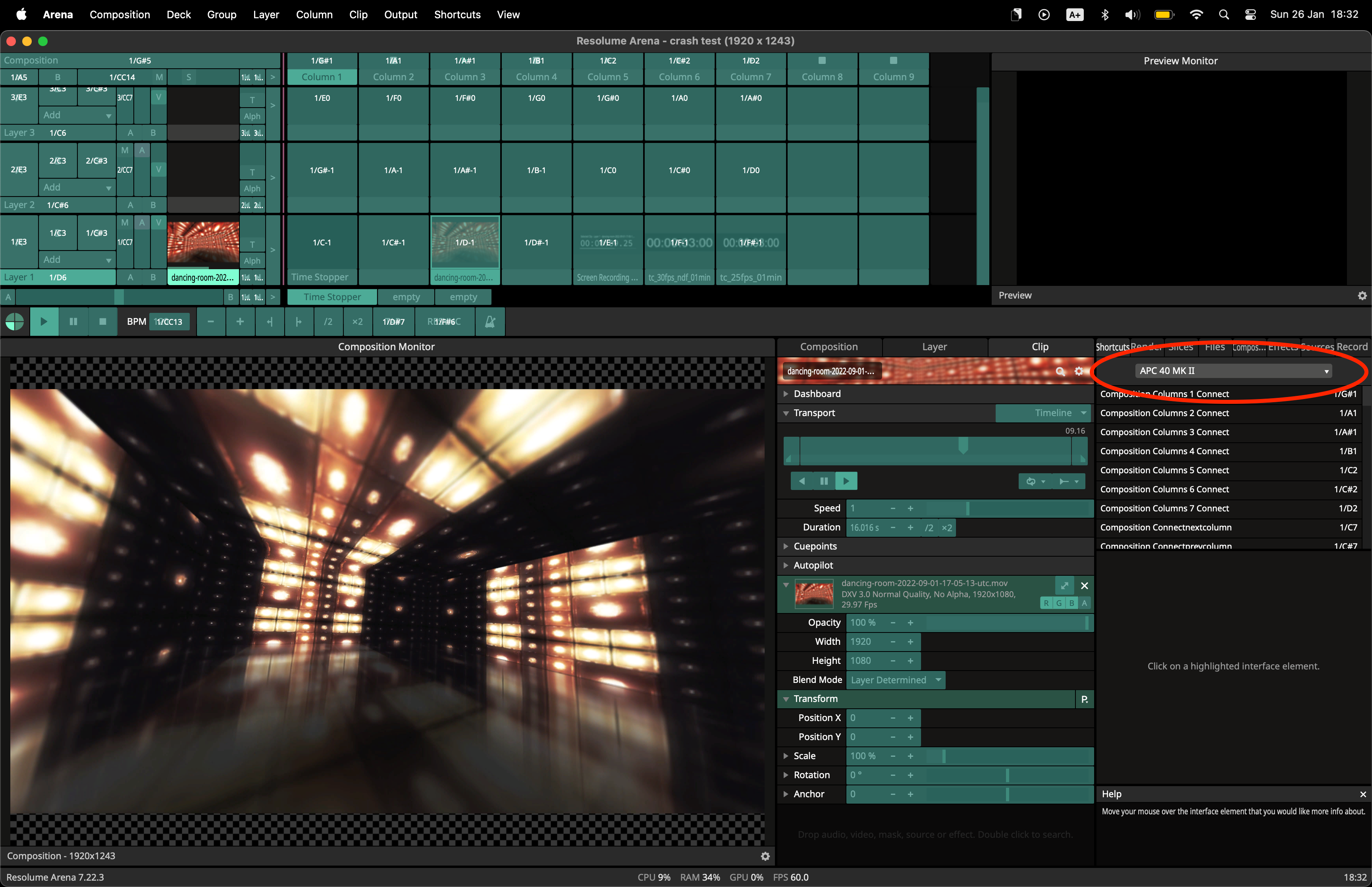

1. How can I load a MIDI profile to a composition? I've read through shortcuts menu/MIDI but I don't see it.
2. How can I save the MIDI profile from a composition?

You can easily make different maps for different set ups and save them. A MIDI map is not automatically saved inside the composition. So every time you want a new/different mapping, select it in the MIDI shortcuts panel

Thanks a lot guys, I finally figured it out!!
The thing was I could never see the little toggle with the different presets when in "MIDI shortcut" mode because of the way my screen was split, it was always covered... Duh!
Anyway, has been making my life a ton easier, sorry for the very late reply!!
