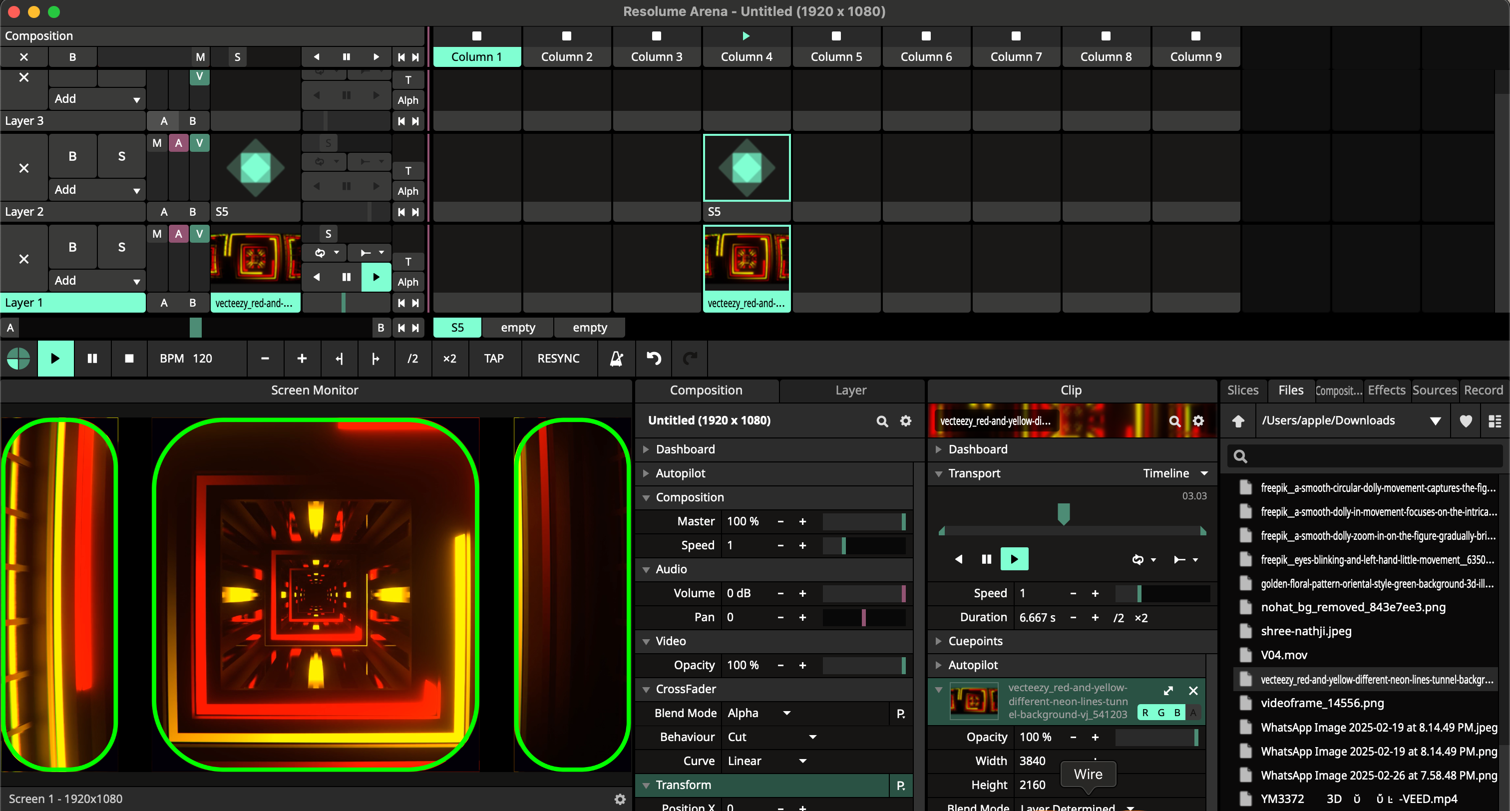

how to fits the mask properly. I am Sending the code

Have a look at the patch I included, it's yours and you were almost there. You just had to use a mask.
Enjoy

Re: BlackMasking
Thanks @tijnisfijn.In the First patch there is no Black masking . it means when i run in Arena . the video under edges are visbile.[1st image]

In the second Patch i created a Black mask behind the edges. it works well.[2nd Image]

Problem is that when execute the 2nd patch in arena . there is little empty pixel occur in edge boundary and the visual playing behind it visible [3rd Image]
i want to fill that Pixel

Re: BlackMasking
The easiest way is to invert your mask. Don't mask out the corners but mask in the centers.
Re: BlackMasking
You can fix the 1–2 pixel video bleed by slightly scaling up the black mask shape in Wire to ensure it fully covers the video edge. You can also make sure the mask has full opacity and matches the exact output resolution of your Arena composition to prevent subpixel misalignment.
