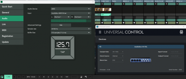

I'm having issues getting Pulse to work. My setup is Resolume 7.22.9 + AudioBox 44 VSL + ShowKontrol. Looks like all my settings are correct its just not flashing green and failing to syncing up. I've tried to adjust the volume levels on my audiobox device, different buffer sizes, different mic/inst and still nothing.
Is there a way to get BPM data from ShowKontrol and link it to Resolume? Instead of listening to the levels wouldn't it be easier or straight forward to grab whatever the BPM says in ShowKontrol? I'm not an audio guy so apologies if this makes no sense

rawdesigns wrote: Wed Jun 25, 2025 07:13 Is there a way to get BPM data from ShowKontrol and link it to Resolume?
Try Ableton Link, but it won't be grid accurate.

thank you Zoltán. Having trouble finding tutorials on how to achieve this. Is it connected through OSC?
