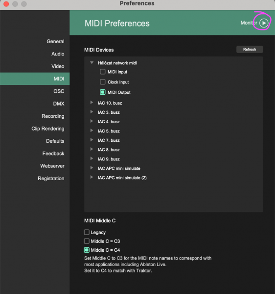

I read about a MIDI monitor under preferences but actually I din't find it, can you send a screenshot of where I can find it please? It would be nice to see if the MIDI note is received anyway when Arena stop to work.

click here for the monitor:
