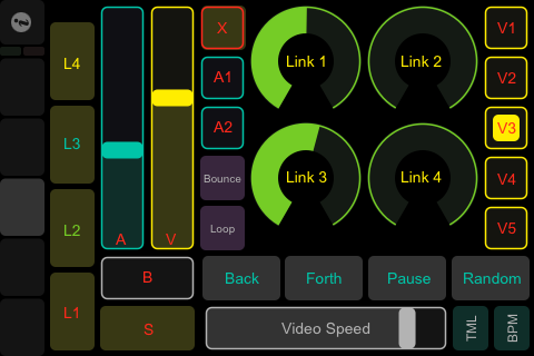

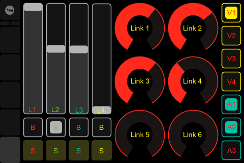

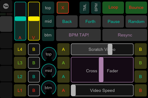

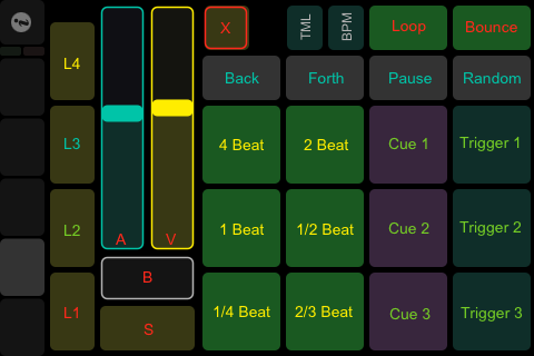

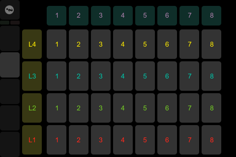

Thanks to advancements in TouchOSC, and VJ Tschoepler for modifying my Beta Layout a new final version of the popular Touch Resolume Layout is here! This new version works directly with Resolume without the need for OSC translation software like OSCulator.
Touch Resolume 1.0
Download Latest Custom TouchOSC Layout here : Touch Resolume 1.0 Layout
What is it?
“Touch Resolume” is a custom layout for TouchOSC that allows you to control Resolume 3 over a wireless network directly with your iphone or ipod touch WITHOUT midi mapping, just load the software and start controlling dozens of functions in Resolume, no mapping required.. Touch Resolume controls Resolume 3.1 directly with OSC commands.
Release Notes:
version 1.0 all functions now work direct with Resolume 3 thanks to VJ Tschoepler
*bugs* – the resync & BPM button hits on the release not the touch.
