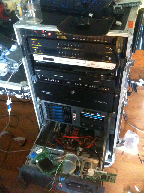

Results so far... (on a asus core i7 mb running win7U 64bit )
Blackmagic Intensity Pro PCIe internal card... Flawless fun, all the way up to HDMI!
I just read this http://www.resolume.com/forum/viewtopic.php?f=7&t=8153! I'd get another BM, but I'm out of slots...
Hauppauge 2250 dual svideo in (PCIe internal card...) Fruitless Frustration ): Especially with anything else capture wise. Have not given up yet, trying it alone in backup machine this week.
And the big shocker, Easy Cap, for 9$ on Amazon. USB svideo in. Works for about an hour then washes out to white. I suspect overheating. I'm going to skin it and slap a heat sink or two on the chips and see what happens. I have three of them, and they all fade to white. Can't unplug with resolume up or the machine will instantly reboot! Can only use one of them at a time in each machine, or I've not figured out how to get to the second one anyway... It does work with the Blackmagic.

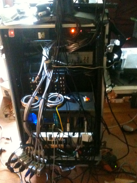

I really wish there existed a 4 input svideo capture device (card or firewire) that was usable by Resolume. Anyone have any of those security system cards working? Things are getting very busy in the back of my box.
