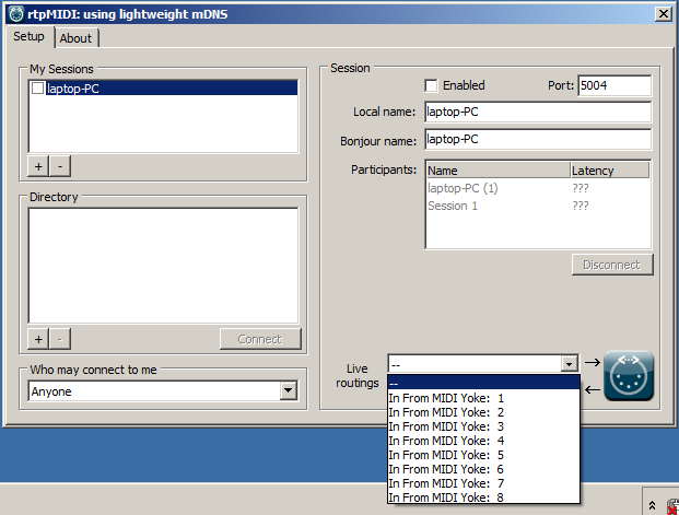

The Pc Midi app is showing midi yoke as live routings.

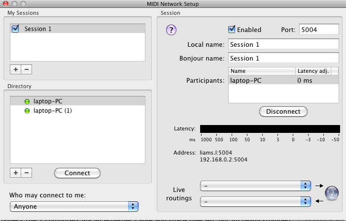

and these are the routings i am getting from my Mac.

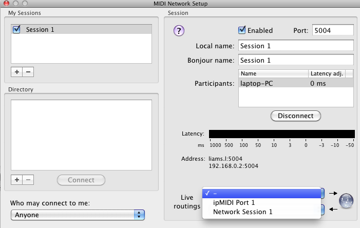

I also did manage just to do this...
Screen shot 2012-08-30 at 14.31.07 copy.png (51.32 KiB) Viewed 21313 times
So they have connected by the looks of it but i keep getting the error message on my PC saying 192.168.0.3:5004 has not answered the connection request.
I'm really lost as to what i need to do now. Does anyone know? had similar problems?

your screenshots show that the rtpMIDI session is not enabled,
therefore the connection to the mac is not established ( this
can be seen because the peers are grey in the participant box)
I also don't understand what you want to use the live-routing
for - this only meant to be used to allow a midi-device that
is connected to the local computer( like keyboard for example)
to be connected to a remote computer.
rtpMIDI creates virtual midi ports all by itself that can be seen
by your daw-software like any other midi-device, so no external
loopback midi cable necessary...

I did orginally have it enabled but at the point of taking the screen shot It had been disabled.
I kept getting this message when it was enable. 192.168.0.3:5004 has not answered the connection request

From your screenshots I would presume the 192.168.0.3 is the PC whereas the 192.168.0.2 is the
Mac. So if you received this error-message then you tried to connect to yourself (probably the
"laptop-PC(1)" session that can be seen as grayed out, but not found in your session list anymore
because you probably deleted it)

In your screenshot I see the title of rtpMIDI saying "using lightweight mDNS". Either Bonjour
is not installed at all, or for some unknown reason you have deactivated the Apple-Bonjour
service on your PC. If that happens, rtpMIDI tries to use it's own lightweight implementation
of mDNS ( Bonjour being the Apple trademark for multicast DNS = mDNS )
If Bonjour is not installed, you can download it at:
http://support.apple.com/kb/DL999

Wow you sorted it for me. I did have originally have Bonjour installed but unistalled, reinstalled and it just worked straight away so thank you! :)
Thanks also for clearing up the other questions i had you've been a real help! now to crack on with the AV show.
