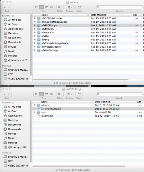

3. Copy the /addons/ofxFFGLPlugin directory to the /addons directory of openFrameworks.
DONE (PIC 1)

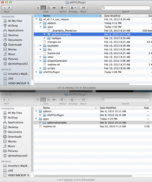

4. Copy the /apps/addonsExamples to the /apps/addonsExamples of openFrameworks.
DONE (PIC 2)

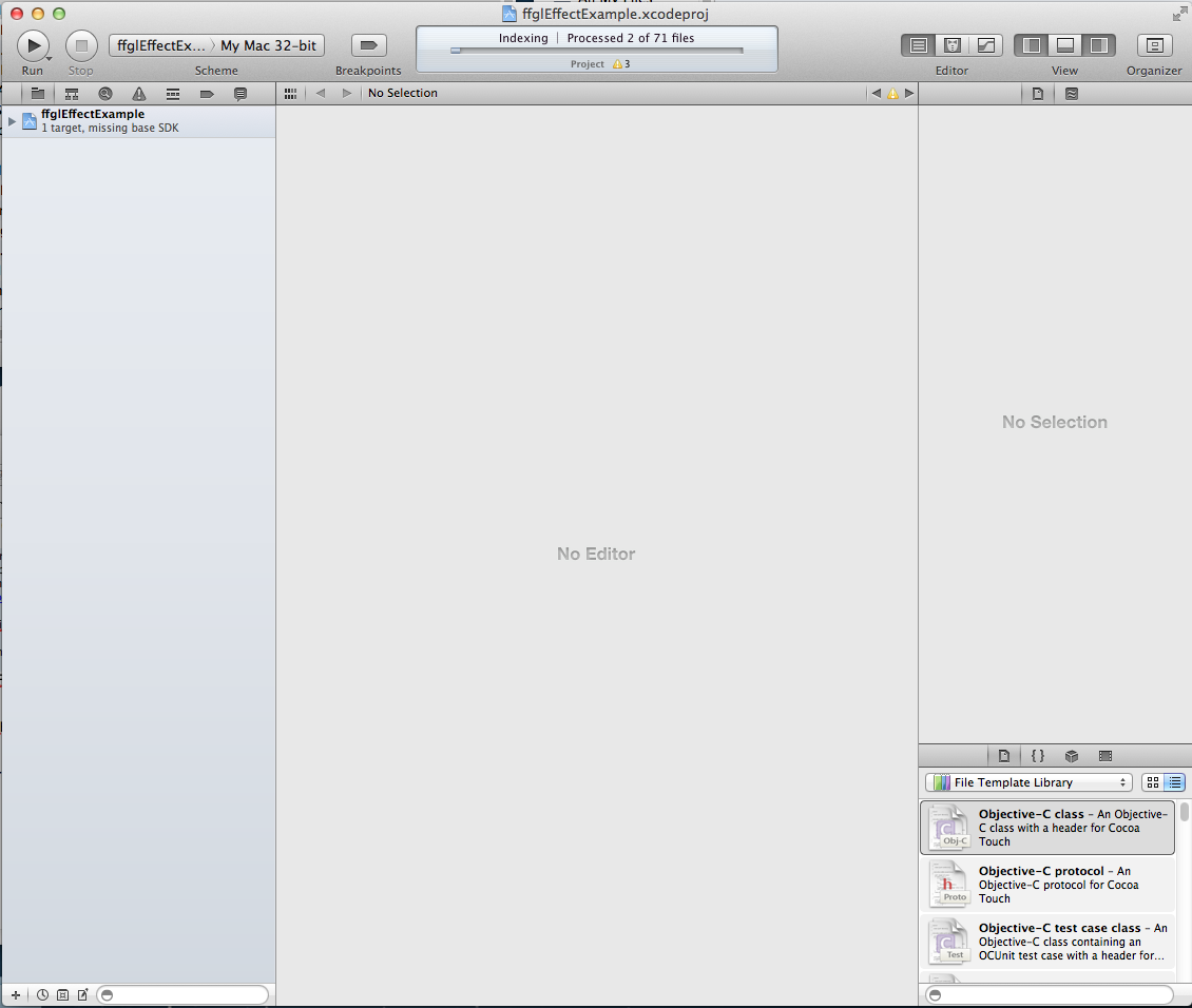

5. Open the project file for one of the examples.
DONE (PIC 3)

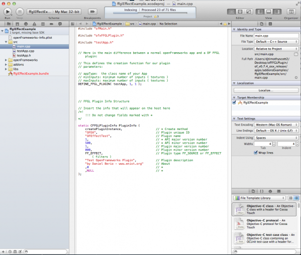

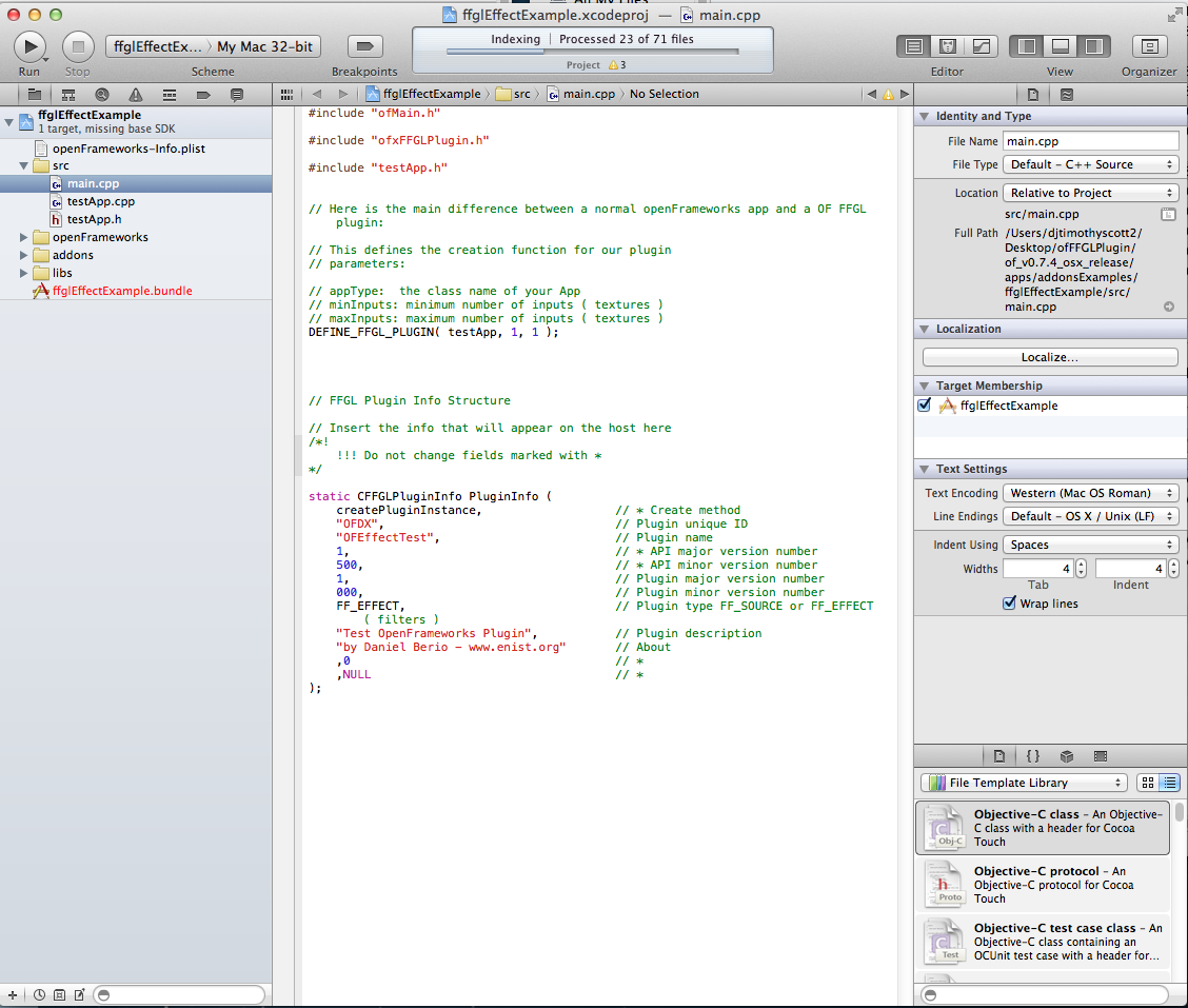

6. In main.cpp: (PIC 4)
a. change testApp with your App class name, if it is different. And set min and max input textures. where do I changes this?
b. Customize the CFFGLPluginInfo struct. Which side, the right or left.
7. If you want to convert an existing openFrameworks app to FFGL, simply change the derivation from ofBaseApp to ofFFGLApp. do not see where to change this option.

It's interesting because it looks like you're trying to convert old FF1.0 effects via Dani's openFrameworks plugin.
openFrameworks and FF1.0 are not the same, and the two links you're following do something different.
Dani's ofxFreeframe addon for openFrameworks is strictly for using an existing openFrameworks project as a plugin in Resolume (it's compatible with oF 0.6 only at the moment). I don't think you have any working oF projects, do you?
BigFug's FFGL wrapper for FreeFrame is a way to get your old FF1.0 effects working in FFGL hosts. It's probably what you're looking for. However, although it's crossplatform, it's not compiled for OSX, and even then I highly doubt you will be able to get .dll files as working .bundles via XCode.
Finally, as to your remark about the lack of FFGL effects in Resolume and on the web, check out the thread of the visuals made by only using Resolume. It blows a lot of the old freeframe stuff out of the water: viewtopic.php?f=11&t=10189
