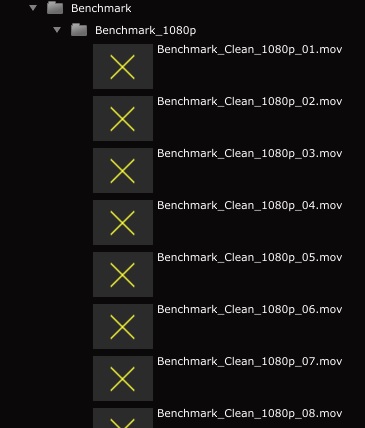

Can you post a screenshot of how the files look in the Res browser?
Re: Files broken afer transfer via USB Stick
yes i can ...
i realy think my Laptop is missing some Codec/ Addon whatever.. because it´s quite new
Strange. Do you have Quicktime installed?
ööhmm.... Huops ... Nope....
i will install it later that day and let you know if this fix the problem....
Sry for the long time to respond, was ill.
Yes the Problem is Solved after Quicktime is installed.
Strange that other .mov / Dxv files work and some others dont.
Nevermind, i thank you for the Help.
