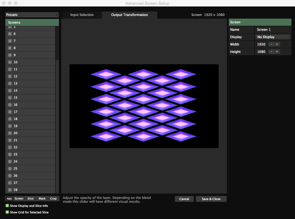

So far I have selected the compositiion setup/input selection to 500x250 to represent out content and the output transformation to 1920x1080 to represent our output projector?
Screen Shot 2015-02-24 at 13.27.54.png (18.29 KiB) Viewed 10851 times

On the output transformation it is very difficult to get a precise view of the edges of the diamond, (as view is so small) as when we go to the venue/and install for the show, I will need to tweak the perspective/points/nodes to fit on the Diamond Wall we create (as there will be many elements/tollerances that will be out/unallighed due to rigging/projector height etc etc.)

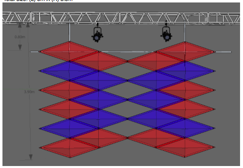

At the moment the 28 diamonds will all be showing the same image/video, but I would like to be able to change the variation and select set clusters/shapes to show different content (i.e not all 28 diamonds showing the same thing) So for instance If I wanted to select a set amount of diamonds to create a shape like below, how would I go about doing this is I have already made 28 diamond slice?
I want to be in a position where by I can then MIDI map the layers/channels to my APC40 Mk2? Is there any tutorials or plugins i need to do this? All I can find is the old APC40... I have the MK2.
Below the 2x variation in colour (red/blue) represents a basic design for different content to be used?

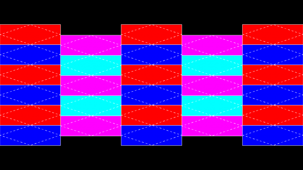

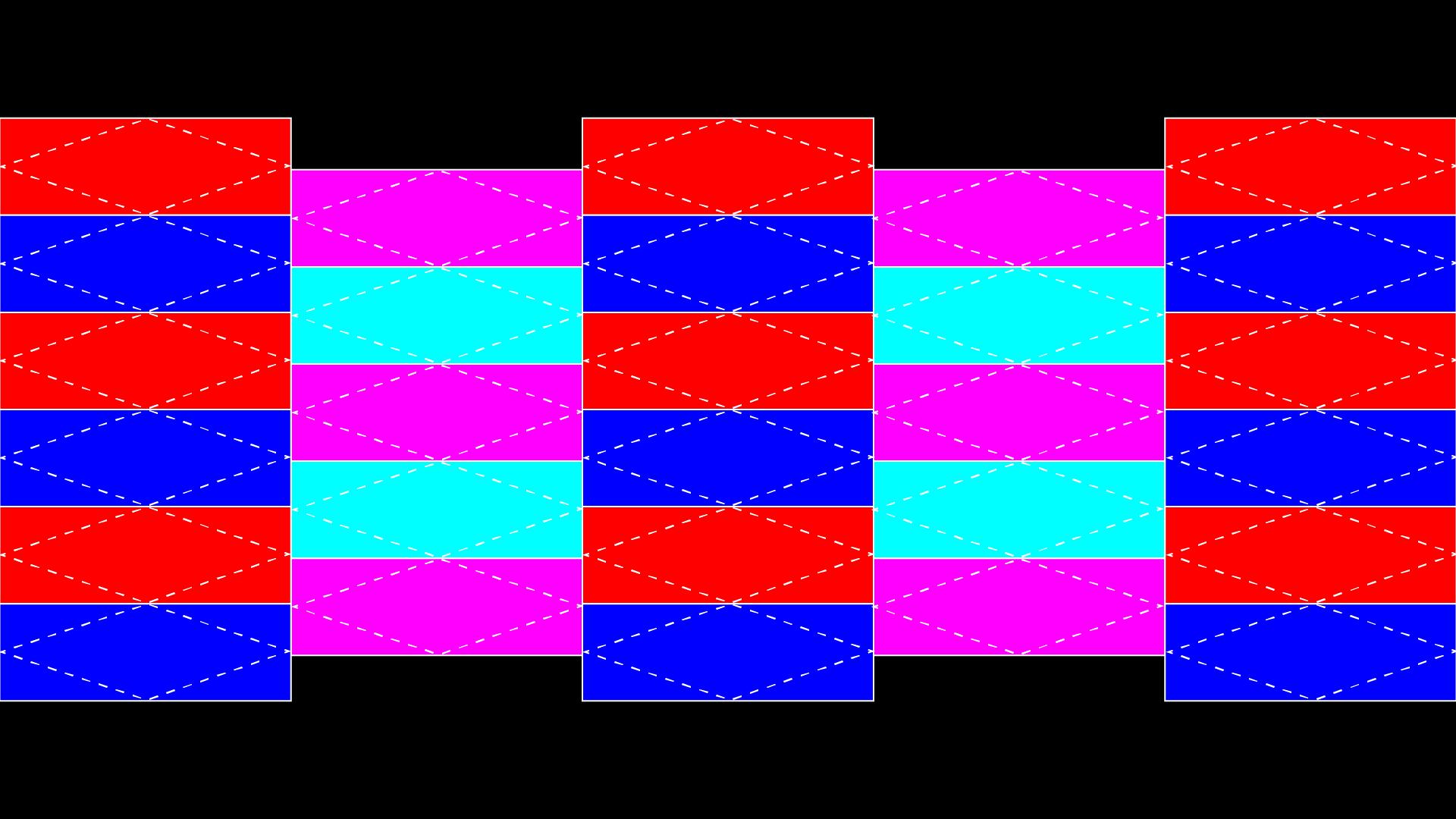

Re: Resolume / APC40 MK2 / NOOB
Layer to slice routing is a great way to quickly prep a mapping show when you have little time. It does have quite a few limitations and is not very flexible once you've set it up.
Especially when you're taking a show like this on the road and need to use it in many venues, I'd take a little extra time and use input mapping. Input mapping involves preparing a grid which has square input areas for each of your diamond surfaces. How big to make it depends on your source content, the aspect ratio of your diamonds and how many layers your computer can handle. Going with 1080p and a 3:1 ratio for the diamonds, it would look something like this.
In Resolume's advanced output, you create 28 slices and use the input selection tab to let each take their input from one of these squares. In the output transformation tab, you warp and stretch each slice to fit your physical object. An immediate advantage is that this is all you need to do mapping wise. On the next show, you only have to adjust the output warping for these 28 slices. Instead of 28 times for every layer you have, which is what you end up with when using layer to slice routing.
Then you take your input mapping still to After Effects, and spend an evening creating different loops from your single diamond animations. You place each diamond animation exactly in a square. But you make each loop special by using different diamond animations in the same loop, offset start points to create wave loops, leave squares blank so you can later on overlay loops in Resolume etc etc.
Even if you're not that handy with AE, if you spend one day creating loops like this, you should have 100+ unique source loops easily, fit exactly to your mapping and ready to play with on each show.
