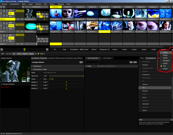

Hi Gradek,
here is the screenshot showing the deck popup list
To Resolume developers> while making this screenshot I noticed these additional issues:
1) Double-clicking on a deck name under the "composition panel" will load it at a random location, sometimes as a visible deck, sometimes inside the pop-up list. So basically if it loads inside the popup list, there is no way to access it anymore.
2) Loading a deck this way does not affect too much FPS, that's good. However there is no "progress bar" or even something telling you that the GUI recieved the command and is loading the deck, except that the whole GUI is not responding to mouse clicks. If you dare to click on any clip thumbnail while the deck is loading this will completly freeze the whole app (Windows says: "not responding"), including frame playback of course, until the deck is loaded. So one has to be careful and patient (about 10 seconds on my machine depending on deck size).
Unfortunately I am going to stop using R3 as long as these issues are not solved:
- deck popup list not working
- composition not reloading all decks with the same arrangment as when composition was saved
