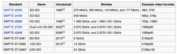

Keep in mind that the great majority of Blackmagic hardware is designed for broadcast which means it will NOT take typical 4:3, 5:4, 16:10 computer resolutions such as XGA, WXGA, UXGA, etc...Their gear is always compliant with Serial Digital Interface SMPTE standards even when you use HDMI so you need to be sure you can work with SD (NTSC & PAL), HD (720p, 1080p, 1080PsF & 1080i), 2K (1080p & 1080PsF), UltraHD (2160p) and 4K (DCI 4Kp) at resolutions of 23.98, 24, 25, 29.97, 30, 50, 59.94 or 60Hz Anything else won't work!
Current SDI SMPTE standards are and anything above 3G-SDI is still mostly unchartered territory:
