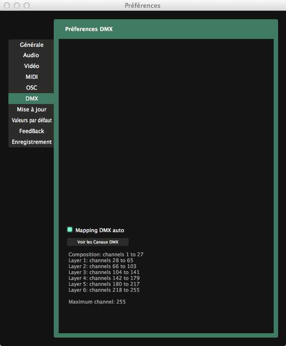

I've some problems since the 5.1.X update with OSX 10.8.5 :
The DMX tab in Preferences is broken
And nothing happens when i click Fixture Editor & Advanced output.

Just made the 5.1.2 update, the problem is still here :
- DMX panel is broken
- Nothing happens when i click in Fixture Editor & Advanced output

Everything works well.
I don't know what you did, but now my fps is higher
Thank you very-very much Resolume HQ :)
