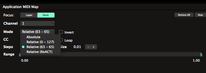

Sounds like those knobs are sending relative midi values.
After you assign the midi shortcut, in the bottom left of the interface, change the mode from Absolute to Relative.
Which mode is right for you (0-127 or 63-65), depends on your controller.
