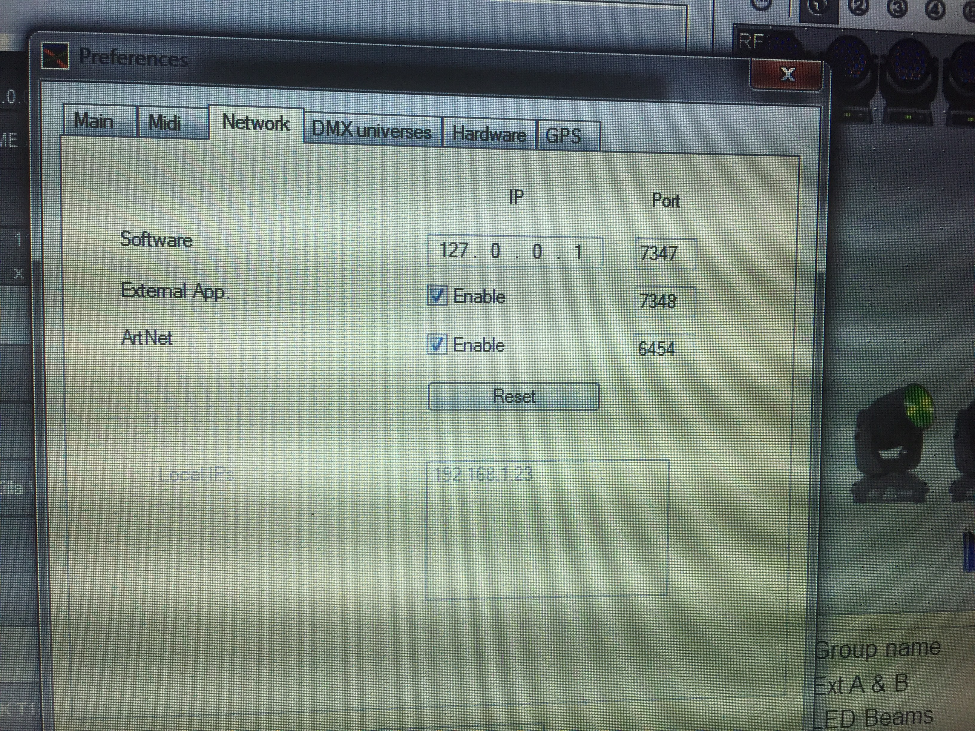

From what I understand, it does do Artnet. I have a Xpress 512. I have attached a photo showing artnet in Showxpress

You're right, apparently you can use Artnet with ShowXpress but only when you have one of their interface connected and as per their website:
As far as I can tell there is nowhere you can set Subnet or Universe so you might want to contact Chauvet directly to find out how to do that. By default, Arena's ArtNet Input would be the IP address of your computer with Subnet = 1 and Universe = 0.With V8
Each 512 channels dmx interface opens 512 dmx channels + 512 Artnet channels (or 1024 Artnet channels)

Clearly communicating what you have and what you have tried is going to be the key to getting help on either side. Look at my signature, it is literally there so people can see what I am running without me having to type it all the time. I wouldn't even know that you were a Windows 7 user until your second post and looked at your screen capture. Then compared that window to what Win OS I remember that frame from. Honestly, that is leaving all the work to us.
Have you disabled the Windows firewall?
Did you try Joris's suggestion of Universe 0 & Subnet 0?
Maybe try describing a step by step here of what you have done in Resolume so that we can follow your work flow. Maybe post a screen shot under Arena-Prefferences-DMX to see what you have tried.
