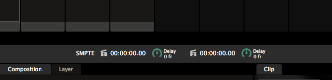

Is it actually the timecode which is not seamless, or does the clip playback itself cause the problem? You can check whether the timecode is received correctly in the toolbar in the center of the interface.
