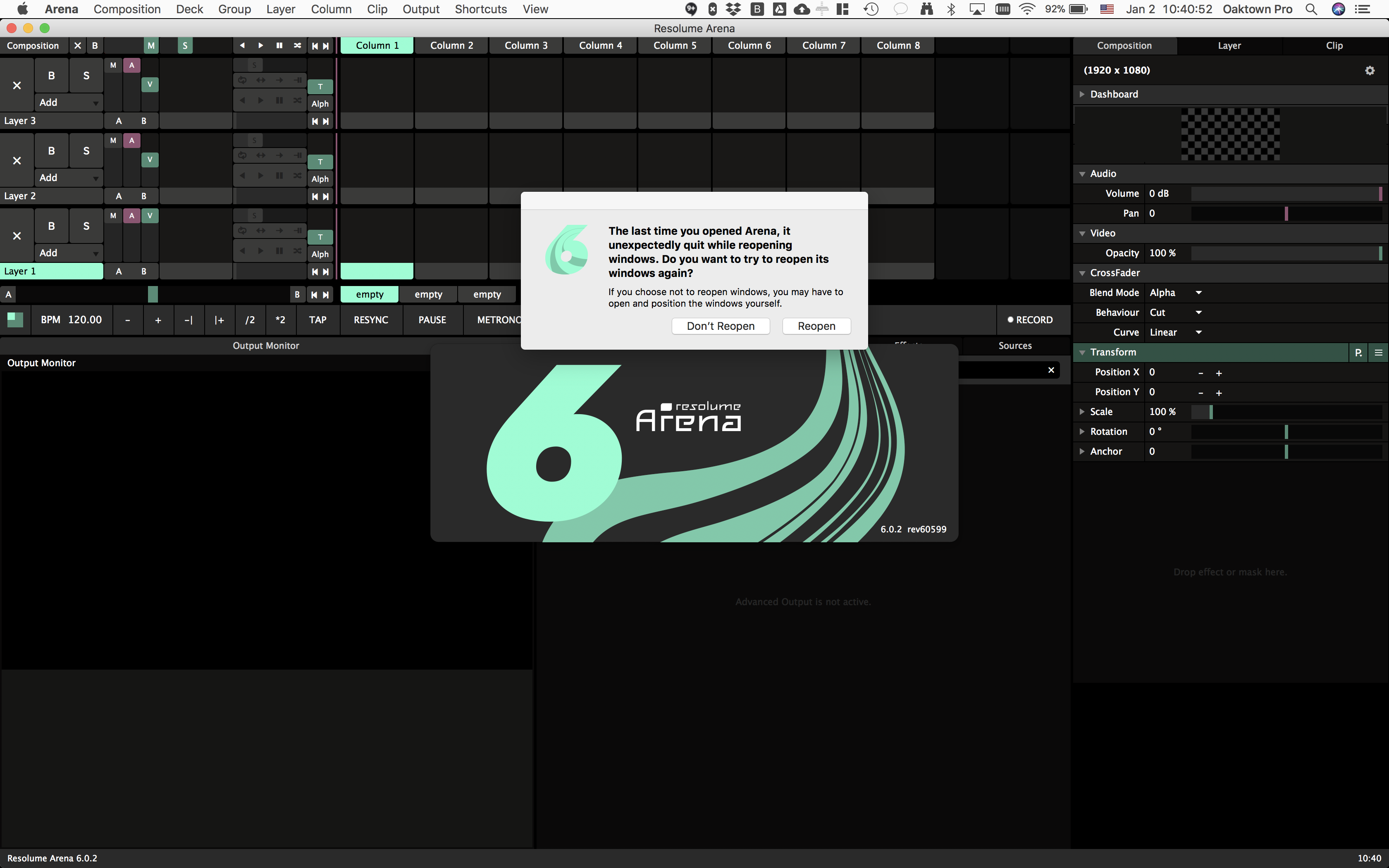

I currently have Arena 6.0.3 installed on two 2017 Macbook Pro with AMD Radeon Pro 560 and one NUC with Nvidia 1080GTX and I've been having issues opening Arena on one of the MBP where it crashes during the startup,
I have gone through all the various steps to fix the problem (trash config file, reinstall 6.0.3 and roll back to older version) but I still can't open Arena. I'm attaching the log file and the screenshot that I can take when I'm able to hang the process (it usually just crashes). Arena 6.0.3 opens fine on the same computer if I switch users.
