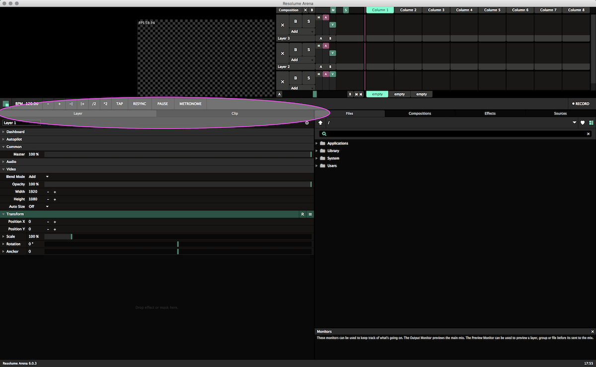

Preview monitor size settings are not retained when R6 is restarted (although the titles of other panels are then correctly shown). See attached 'after restart.png'. Unfortunately, I made the screenshot after resizing, so it doesn't show this and I'm too lazy to redo

Moving the Monitor panel around and resizing it causes other panel titles to be hidden. See attached 'titles of panels below are hidden from view 1.png' (please ignore the highlighted square box in the middle, it's there by accident) and 'titles of panels below are hidden from view 2.png'.

, but when R6 is restarted, the Preview Monitor is a lot smaller than the Output Monitor while they were the same size before restarting R6.

I actually try to reproduce issues from default settings, to ensure I'm not causing the behaviour somehow and to ensure others can reproduce them with the same steps. In this case I've started out from the default layout and dragged the Monitor panel to the top left, attached to the Layers panel.

I could recreate with the Output monitor panel texts, needed a Resolume restart to actually break.
I created a ticket. #10648
