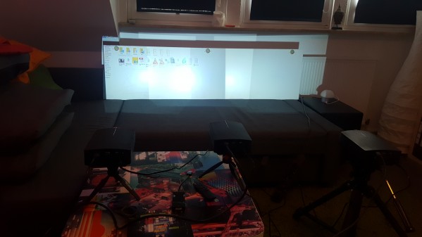

1. In Resolume softedging it's truly software based. There is no connection to the projector. So you can do it with any projector. ANY....even if they are different...but the result would not be that nice.
Here I tested edge blending with 3 70,00€ china led projectors....feeded from one 1080 clip in Resolume...you loose pixels...because the aspect ratio is not 16:9.....it's much wider....so the image is cut at the top and the bottom.... 2. Yes...short... every projector needs his own output from Resolume for softedging.
best wishes
best wishes
