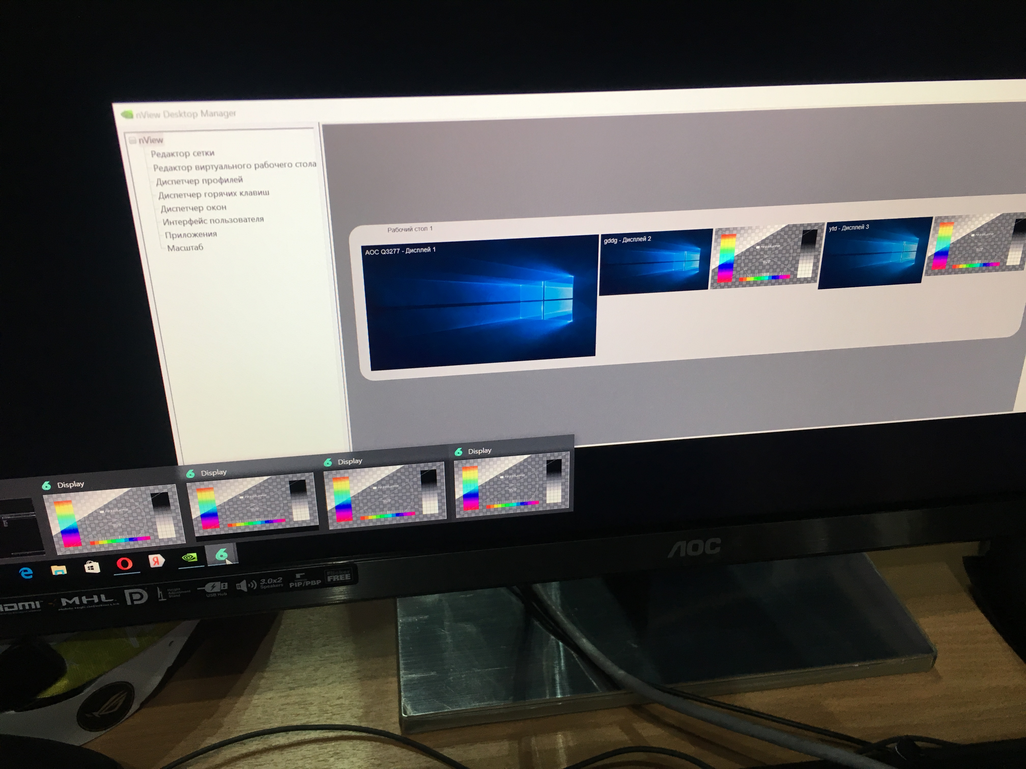

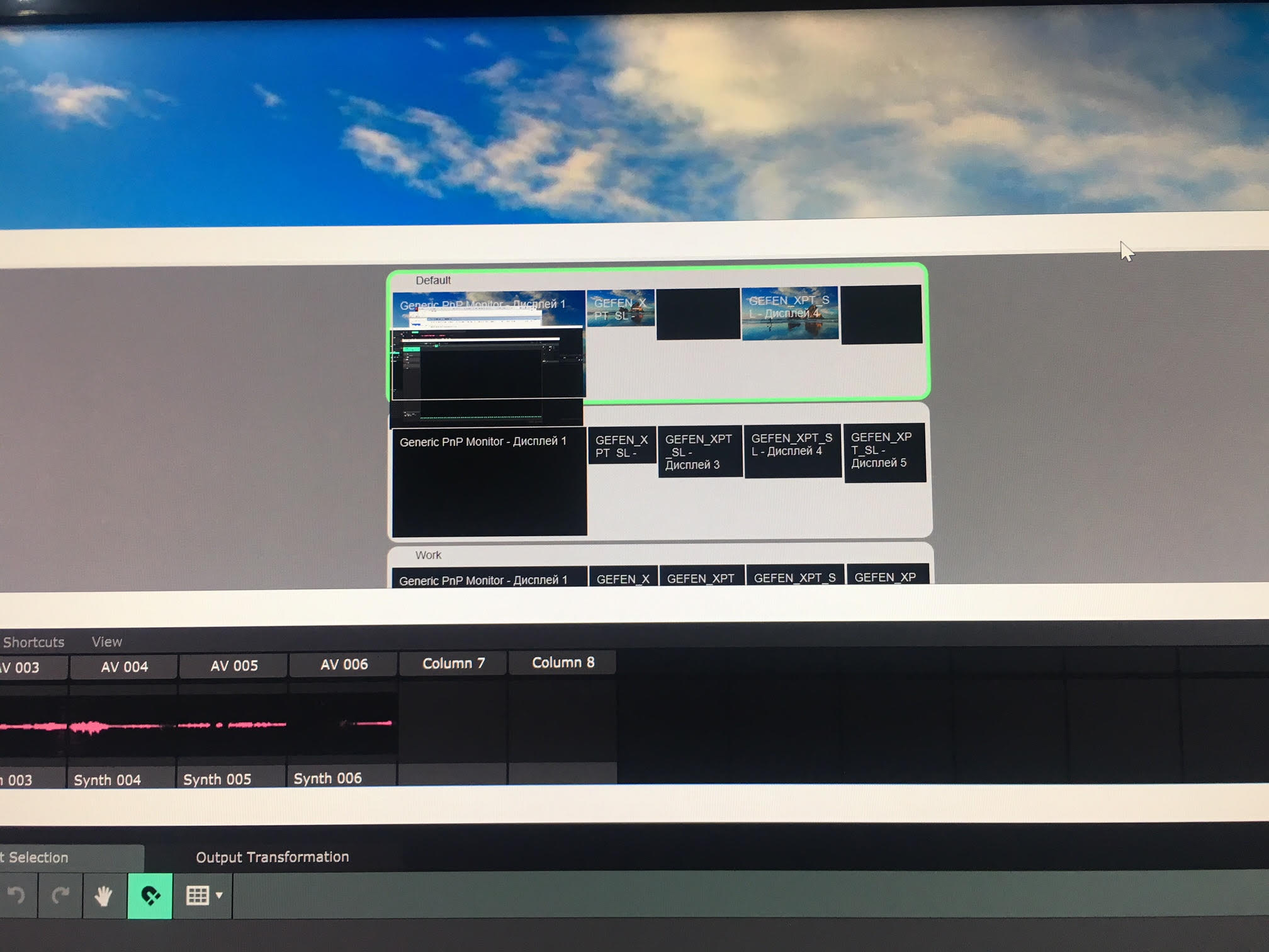

Resolume 6 does not turn on full screen mode, while resolume 5 works fine. Reinstalled resolume 6 and drivers on the graphics card-does not help. what could it be? the computer is the same
1 photo - resolume6
2 photo - resolume5

How does your overal setup look like? To what are you sending it?
KorvetV
Joined: Wed Nov 29, 2017 11:16
Re: FullScreen
Post by KorvetV »
Quadro P4000 graphics card. All 4 outputs go into the matrix (3-with a resolution of 1080 and 1-with a resolution of 1200)
Resolume 6 why not fullscreen displays on all screens in the settings all are correct.

Could you please try & check the following?
- Seems your GUI is 4k, set it on HD
- Make sure that your UI scalling within Windows is all set on 100%
- Set all your outputs on 1920x1080
Does then the problem still persist?
