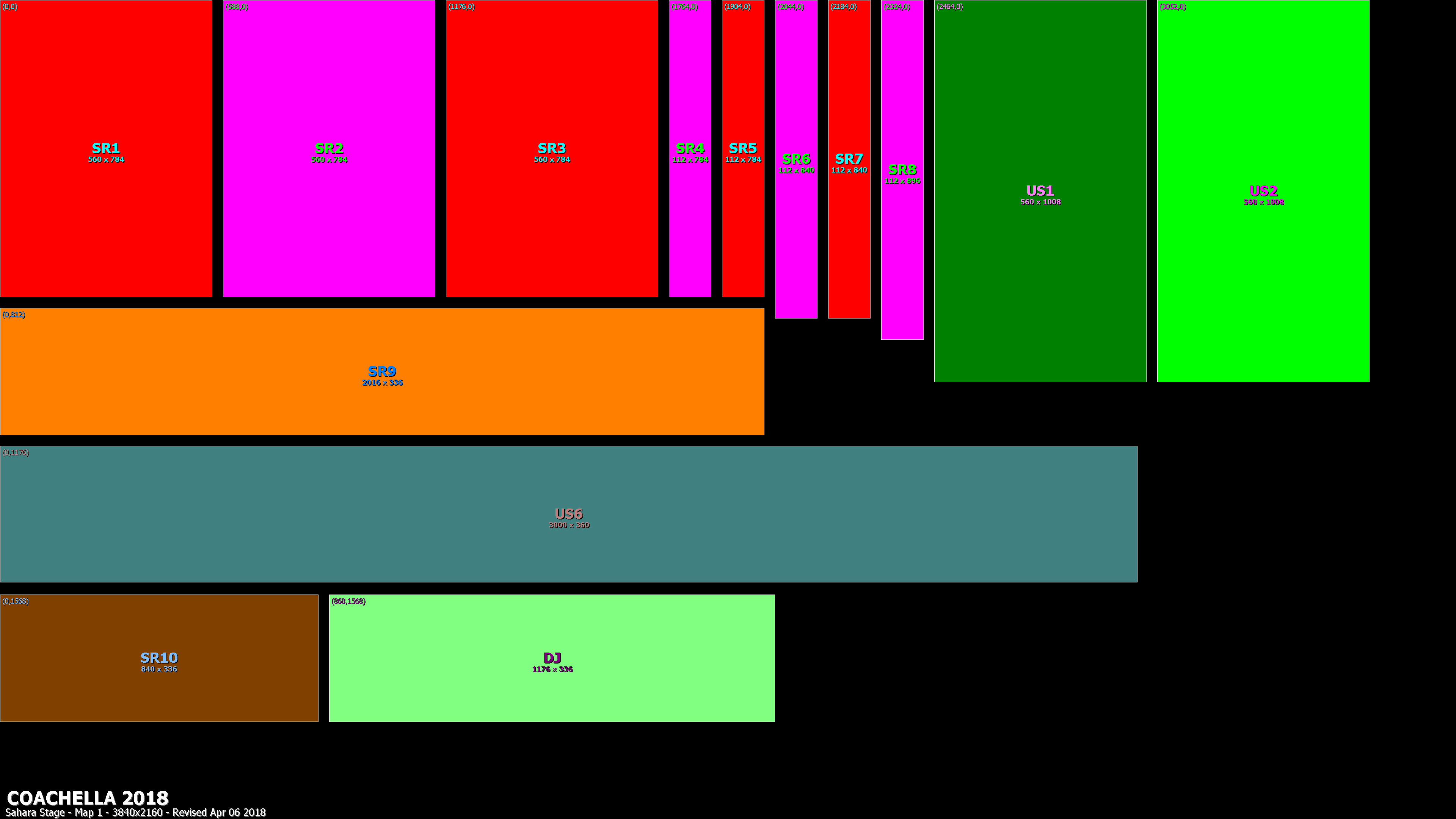

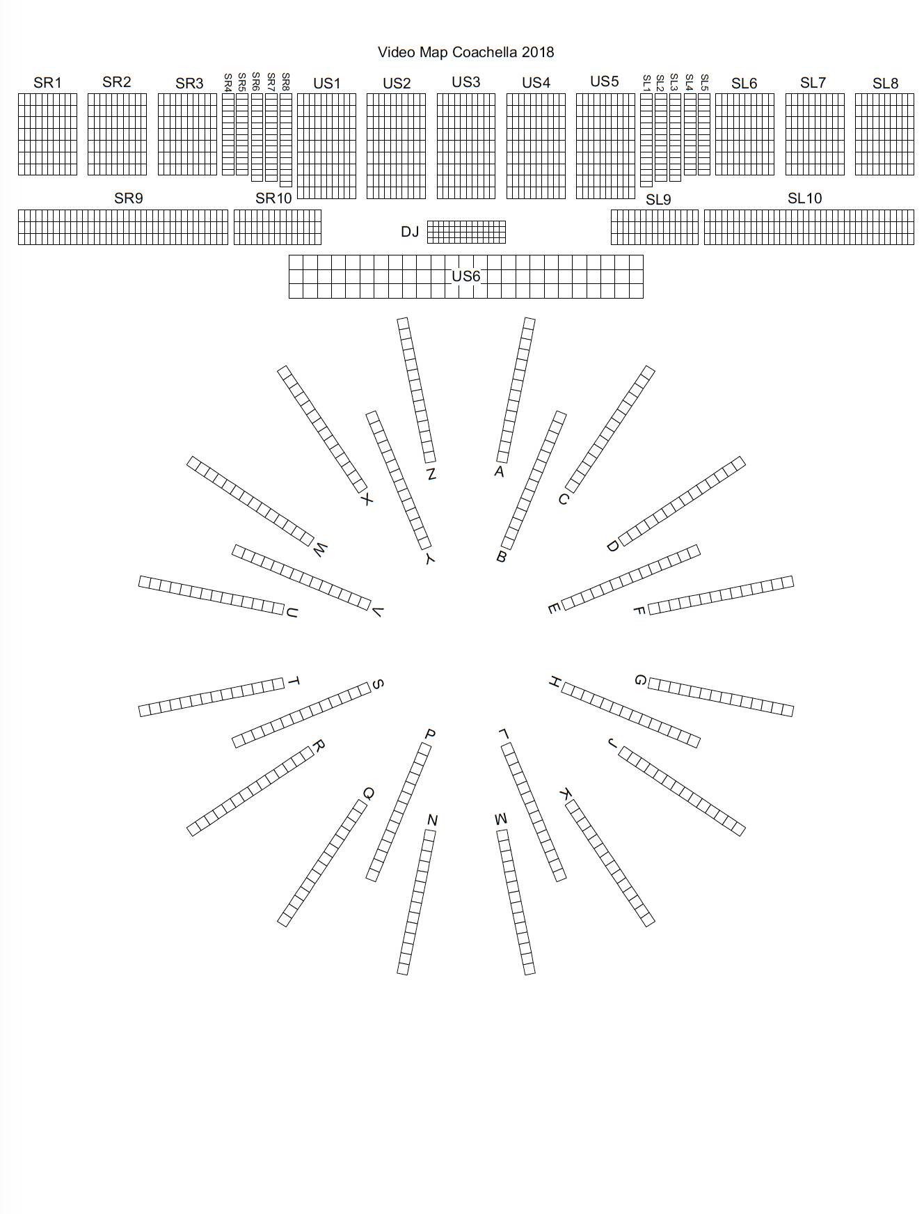

Here are the video map & pixel maps of the Sahara Tent at Coachella 2018:

Since the majority of the live show is run by MIDI from Ableton I am able to focus more on mapping and how all the content fits on the stage. For extra- large stages I use a combination of the Mapper plugin from Dvizion as well as Chaser.
Mapper handles the overall placement and look of each video and I use Chaser for some extra flair. One way I organize my looks through Chaser, is to create an extra screen that is not outputting for each look. This gives me room to play around while knowing that I will not be messing with anything on the output side.
There is a point in the show where I flash the Illenium logo in a grid that is formed by the design of the LED panels.
Because of the 2 x 4k outputs, I had A LOT of pixels to work with. I ended up with 473 number of slices across the whole input map. If I could redo it, I would increase the scale of the grid because the number of slices loses your eye too fast for the amount of time I use this part.
