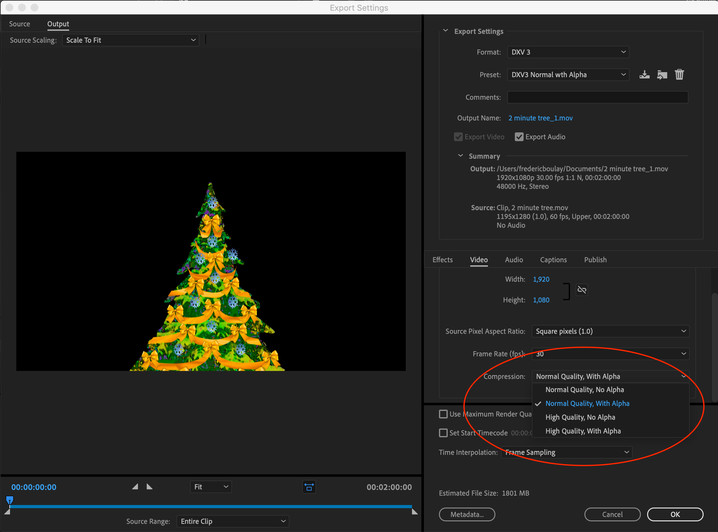

Here's the DXV dialog:

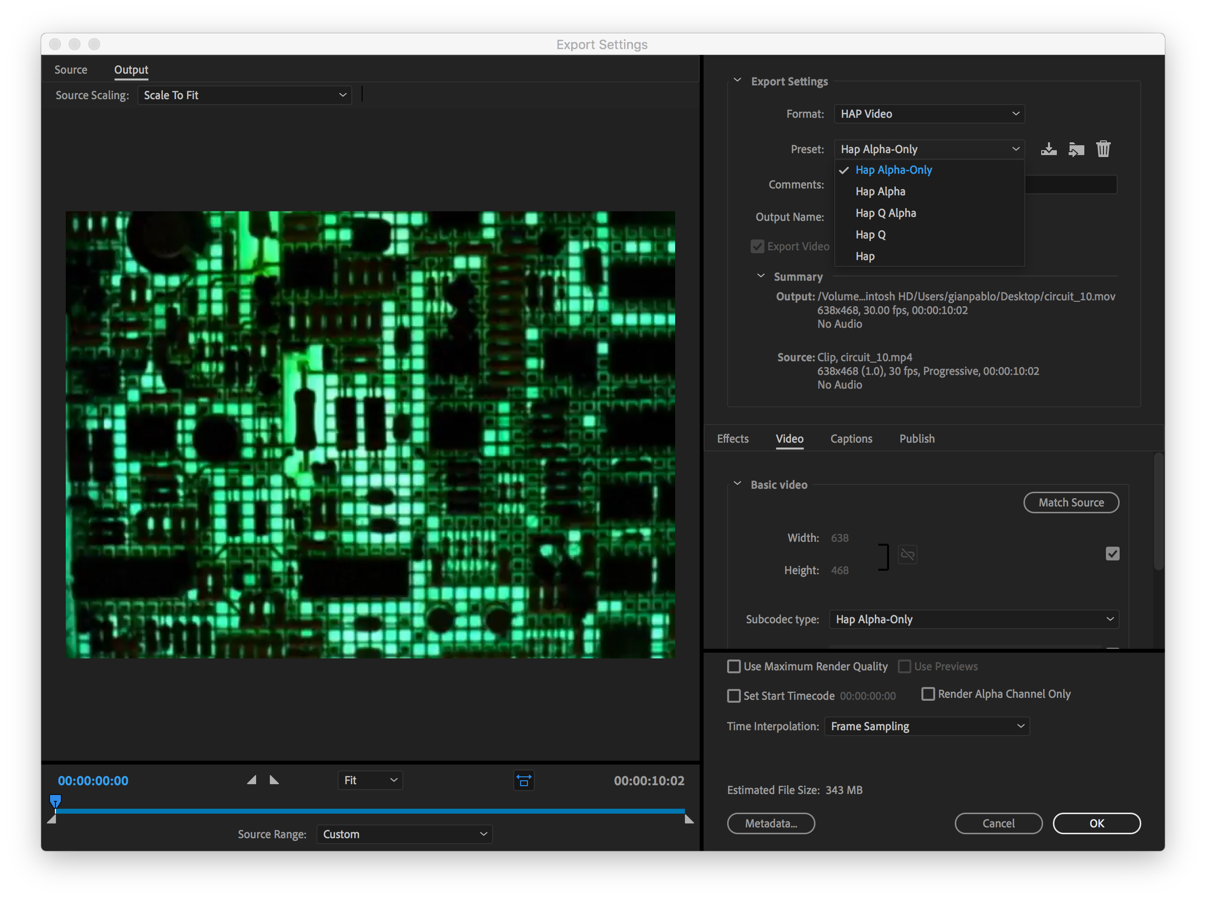

And for comparison here is the HAP dialog:
Re: How to Match Source encoding DXV in Adobe?
Unfortunately there is no [Match Source] with the DXV3 codec in AME
As far as the DXV setting, you'll need to scroll up!

I'm sure you know this, but there is an "official" HAP encoder for Adobe, and it is open source.
https://github.com/disguise-one/hap-encoder-adobe-cc
Perhaps you could look at how they get the Match Source feature to work?
