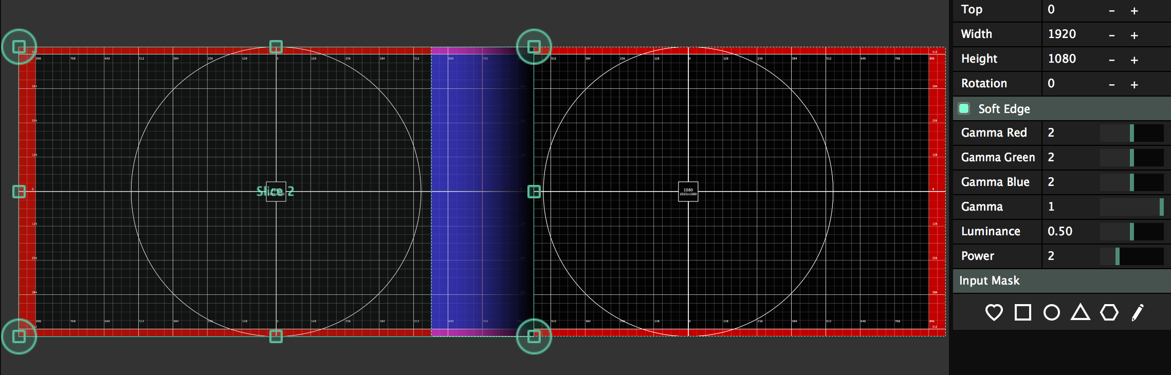

here is a line up I made for my own work
the overlaps are highlighted to make lining up slices in resolume easier.

@deepvisual: The slices do overlap. My pictures are made from the "Output Transformation"-Tab, yours from the Input Selection. My Input selection looks like this:

Re: Problem getting the soft edge just right
Ok.
So it looks like your power settings are way too low.
try resetting gamma to 1, luminance to 0.5 and power to 2.
sliding the power up will make the blend darker.
