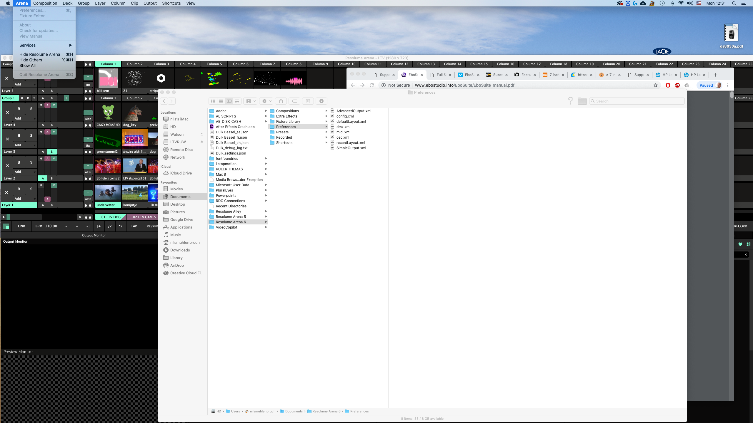

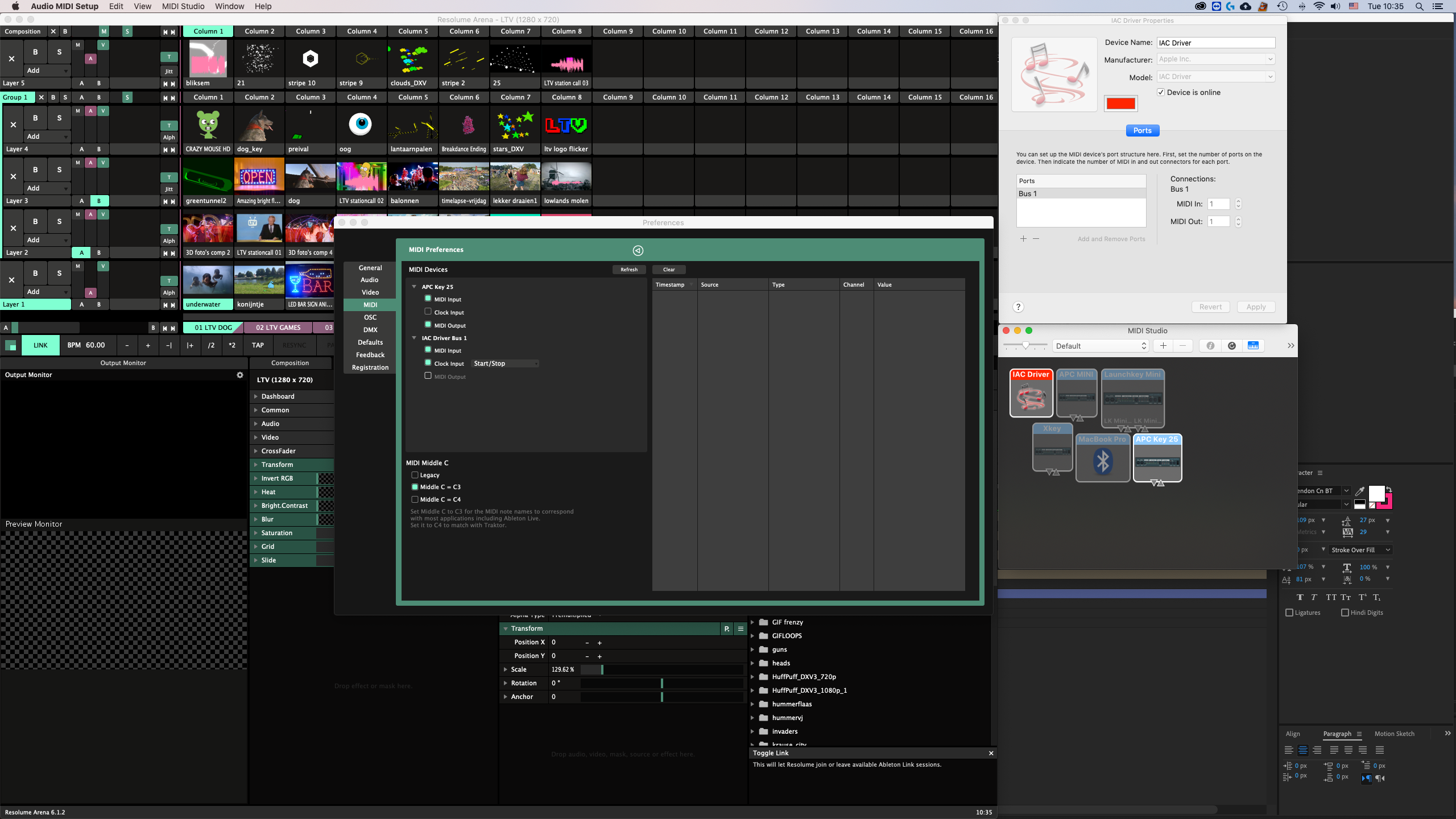

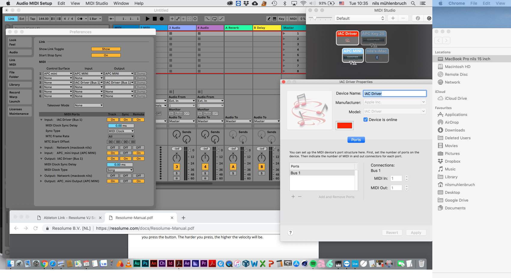

It did work indeed but now it doesn't. Both mac's are on the same network, i enabled the AIC driver (bus 1) in MIDI set up on both machines. Selected MIDI input and CLock input in Resolume preferences. I suspect there is a problem with Resolume not being able to connect to the network at all. I have this strange problem that when i choose 'Check for updates' it freezes the menu and (i think) starts searching endlessly for a connection. The menu then is greyed out and i can't close the program and have to force quit it.
I know you have to permit resolume to make a connection but i can't find this is the menu's

You don't need midi for Link, it's a separate protocol entirely.
Try disabling the firewalls on the macs, in the OSX system preferences, Security.
