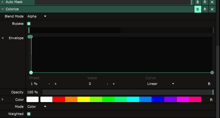

I'm on 7.0.5. Tried using envelopes.
Using the envelope from the picture works as expected as long as operating the envelope directly or midi
When I map DMX and send signal using DMX workshop from same pc and separate pc, I have to invert the signal (not that way with midi). It almost ignores the envelope I've made and uses the 1% cut I've made as an offset for the bypass. Video attached (running DMX workshop on separate PC to record video. Moving dynamically through single channel at the fastest speed available. If if move the fader with the mouse, the bypass value jumps all over the place
