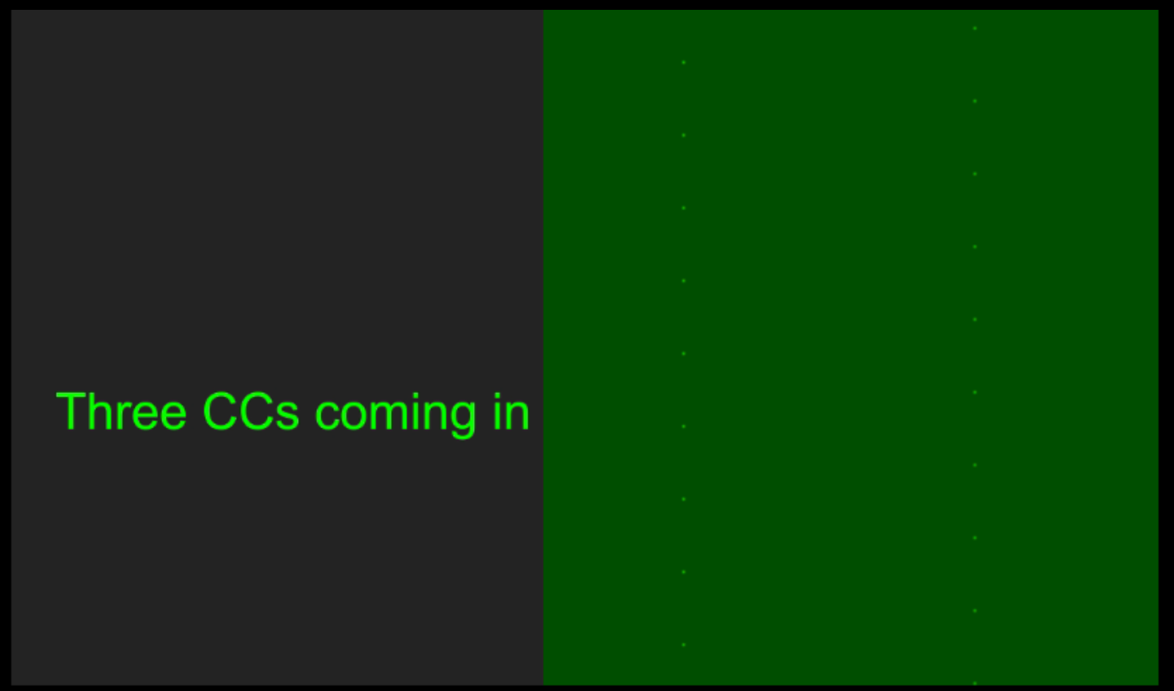

Attached is an mp4 screen recording of me switching 3 basic midi LFOs on in ableton that are transferred to CC messages in ableton, then sent via an external instrument via loopmidi (https://www.tobias-erichsen.de/software/loopmidi.html). I've just mapped them to 3 random parameters, it doesn't matter which ones, they all have the same effect.
As you can see, 1 cc message is fine (not perfect, but useable), then when I turn on a second and 3rd, they hang and glitch.

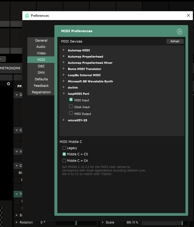

Could you please send us the Resolume log file via the feedback tab in preferences, and a screenshot of your midi preferences?
Re: glitches and lags when using midi cc internally
Hi, here's the screenshot of midi prefs, (note that all other midi controllers are all turned off) I'll send the log file from the auto email thing in preferences.

3 CCs from Ableton to Resolume works smoothly for me to both Resolume 6 and 7.
Can you try to send to another app or check the midi with a monitor tool if the timestamps are in specific intervals?
Do you see these glitches which are in your screen recording also on your monitor?
