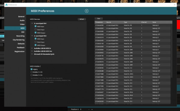

Could you post a screenshot of your Midi preferences, and send us the log file via the feedback tab in preferences?

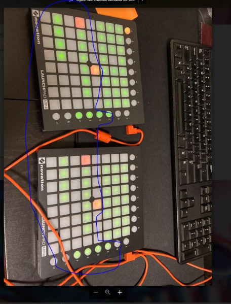

HI
please find in attach thre requested files. On the the MIDIlaunchpad file you can see buttons lite up that are not supposed to be.
