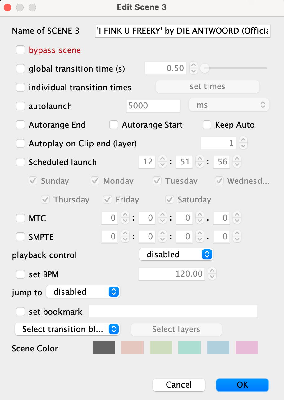

This one could do what you'd like, Ignore column trigger helps a lot.
