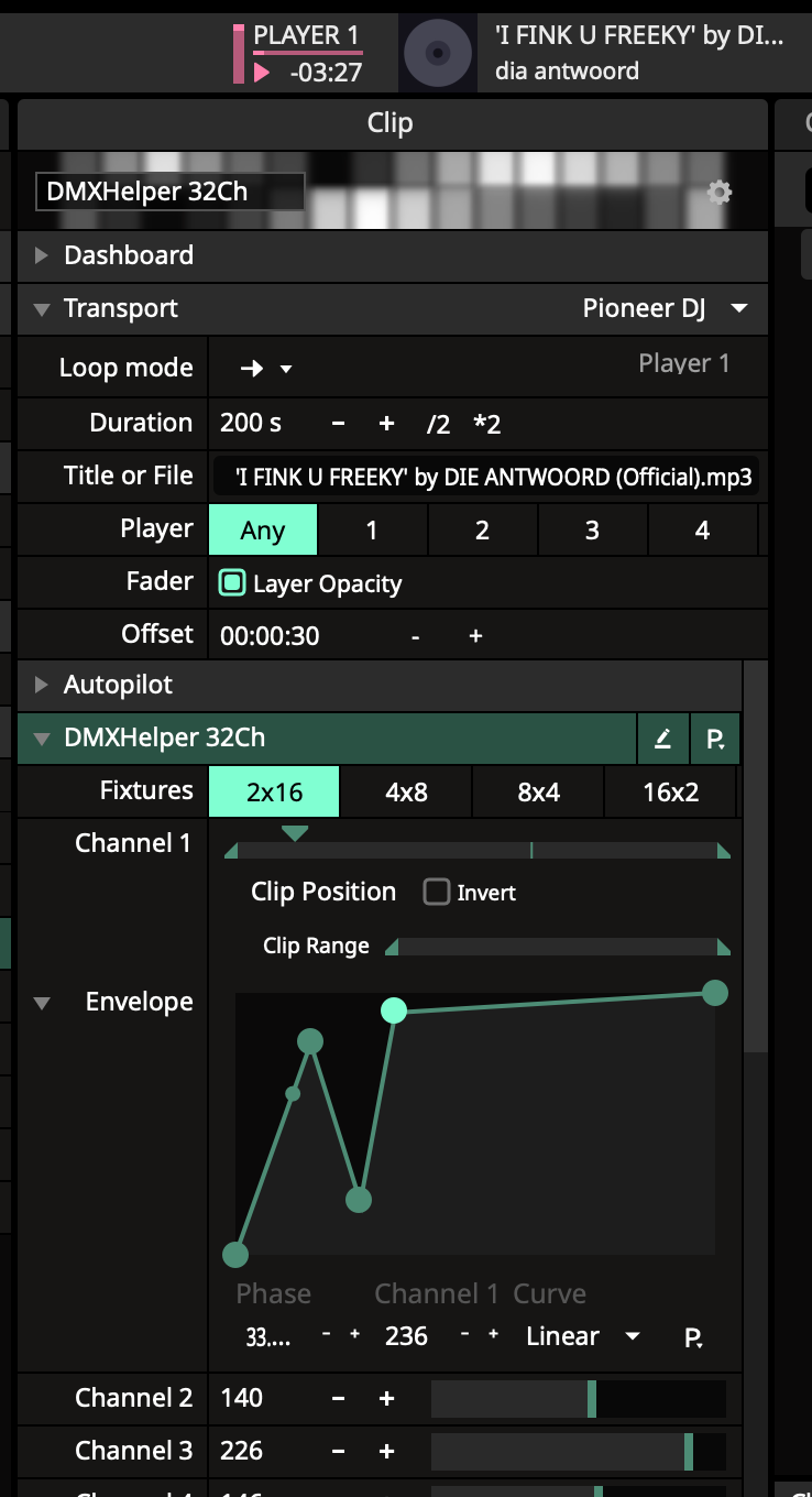

If you'd have a CDJ playing tracks, (Pioneer Bridge app is free)
You could assign the tracks to the helper clips, set the duration and TC, and set the parameters to Clip position automation, and add envelopes to animate the values. That will play automated without rendering out stuff.

Oh wow... I've been out of the loop.
I had no idea that feature had been added (6 months ago). Yet another reason to upgrade my license!
That's great. Thank you!
