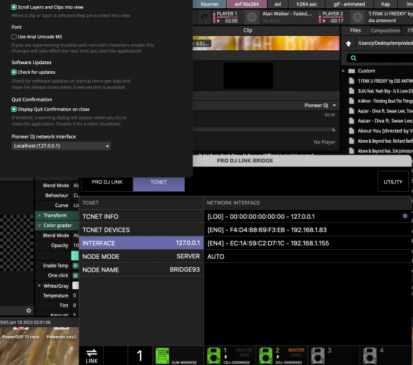

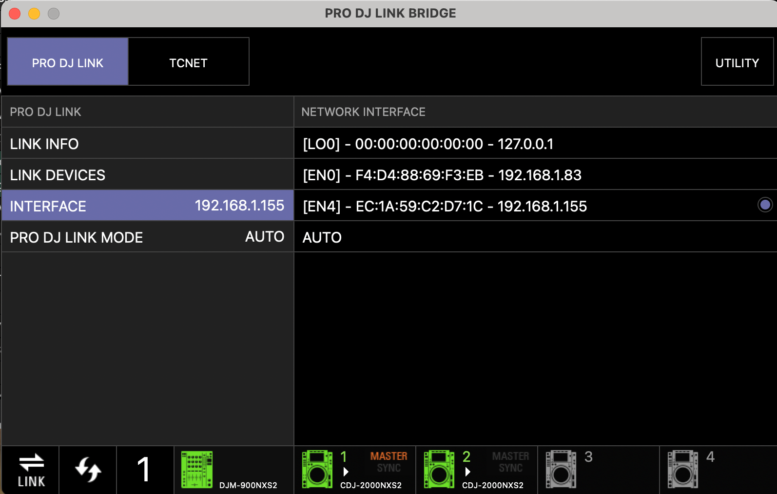

These settings work just fine for me on Ventura, 192.168.1.155 is my wired adapter
