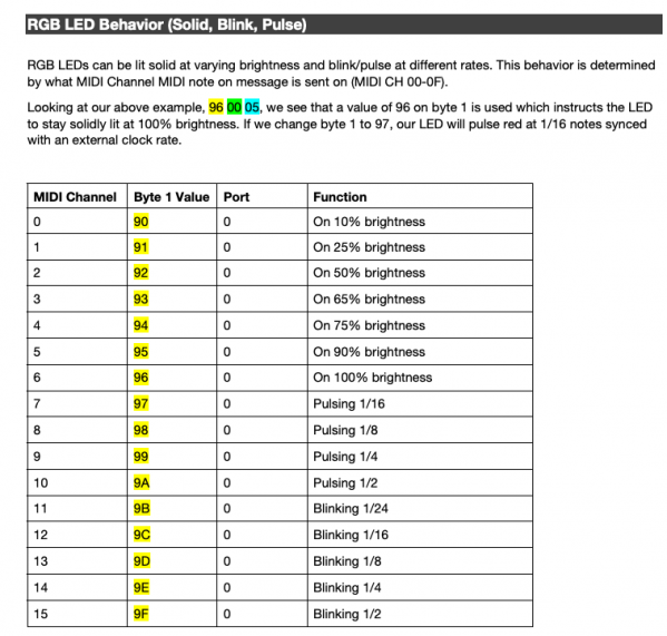

I'm having an issue where the pads are extremely dim and the only way to turn up the brightness is to assign the channel from 1 to 7, which makes the buttons unresponsive. also very difficult to customize the colors of the pads, not as straightforward as the full sized standard MK2.

APC 40mk2 on channel 7 blinks the buttons for me.
What's the mode you have set in Resolume midi preferences?

I'm having the same problem.
I'm not sure how to change the channel on the controller. But I can also report that the LEDs are very dim and only change when you set the channel to 7.
Whatever the default is for connection are the settings I have it set for.

https://cdn.inmusicbrands.com/akai/atta ... 20v1.0.pdf
Looks like they made channel 1 to be the dimmest color, yeah, that sucks.
Does Ableton provide a device editor for the APC mini, maybe you can change the output channel?
