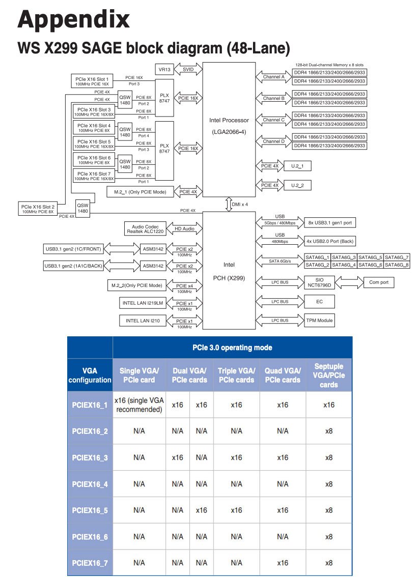

CPU offer 48 lanes, mobo utilize 44 of these + DMI can have the last 4 CPU lanes assigned in bios directly toward the southbridge chipset for increased speed between south and northbridge.
MOBO LANES (added picture of lane appendix)
32 lanes directed to PLX chipset.
From PLX chipset 64 lanes to PCIE-bridge.
Mobo has 7 slots of 16x mechanically and offers electrical configs such as follows:
16x, 0x, 16x, 0x, 16x, 0x, 16x
16x, 8x, 16x, 0x, 16x, 0x, 8x (Could this work? this is not announced)
16x, 8x, 16x, 0x, 8x, 8x, 8x (Could this work? this is not announced)
16x, 8x, 8x, 8x, 16x, 0x, 8x (Could this work? this is not announced)
16x, 8x, 8x, 8x, 8x, 8x, 8x
So far (and this is a disturbing issue atm) I have not managed to optimize the system as I want.
If I have PGU in PCIEX_1 + PCIEX_5 (this is the recommended setting from ASUS) then I only get the second gpu to run in 8x electrically. Beside all PCIEX_slots that are 8/0x are set at 0x and I can not do anything about it :-/
If I have the GPU PCIEX_1 + PCIEX_3 (here I can get both GPUs to operate in 16x electrically) and also here I can reach all my other PCIEX_slots. Here all other PCIEX_slots that are 8/0x seems to be in working order without issues. They are all set at 8x where connected cards uttulize lanes accordingly to their needs.
- I would love some imput from you guys regarding this
Preferrably I would love to get the GPU going at 8x electrically in PCIEX_3 so I can utilize all other PCIEX_ports in the near future.
