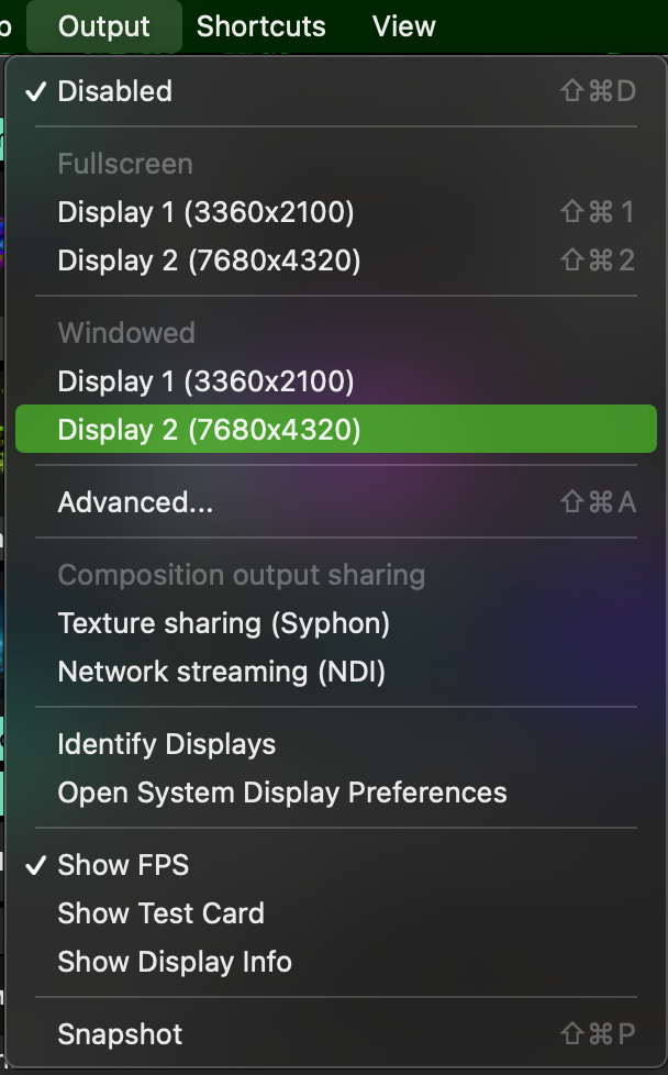

Hi guys !
Mysterious resolutions only on my Resolume.
In a recent gig, I use my MBP 2017 with 3 apple HDMI adapters sending to 3 outputs: one main screen 3360x1200 and 2 HD full lateral panels, plugged to an E2 feeding 3 LED panels.
Everything was going ok, I was getting about 60fps. Suddenly in a reboot, Im starting to get 12fps. When I go to the advanced output, the main screen output was showing 7200x2160, probably the frame rate was getting low because the large resolution plus the other 2 HD outputs. In the end, I have to use my backup PC to play at the gig. VDMX at the same time on the same setup, was showing the correct resolutions.

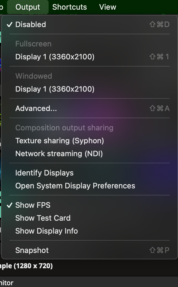

When I came back to my studio, Resolume now show my built-in display is 3360x2100, even with the System Preferences showing the built-in display 1650x1080. If I lower the resolution, I always get some extra pixels ONLY ON Resolume.
When I connect an extra 4K Monitor, the things get even worse, Resolume shows the Display 2 as 7680x4320 (screen shots annexed)
