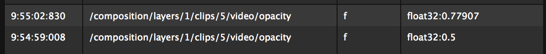

Same here, it works fine.Oaktown wrote:I tested the OSC string for the specific clip both with the layer by itself and in a group and it worked as expected but I didnt test with TDAny chance someone else can try to recreate this issue? Testing out the selected AND the direct OSC paths and see what their results are?
This is what I get in the OSC inspector as input:
