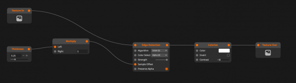

Thank you for your reply,
I would like to retrieve the color to color the line obtained by the Edge Detection.
It's for an effect, for create a second layer with only colored outline. Sending to lasers.

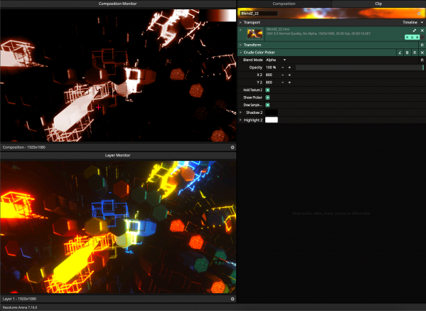

This patch(resolume 7.16) will grab a single pixel and uses it to colorize the incoming texuture.
We made this to demo how to grab a single pixel and hope this helps you on your way.
The CPU<>GPU communication is coming at some point, but for now this kind of workaround might help.

Thank you for the patch, it's a good starting point !
