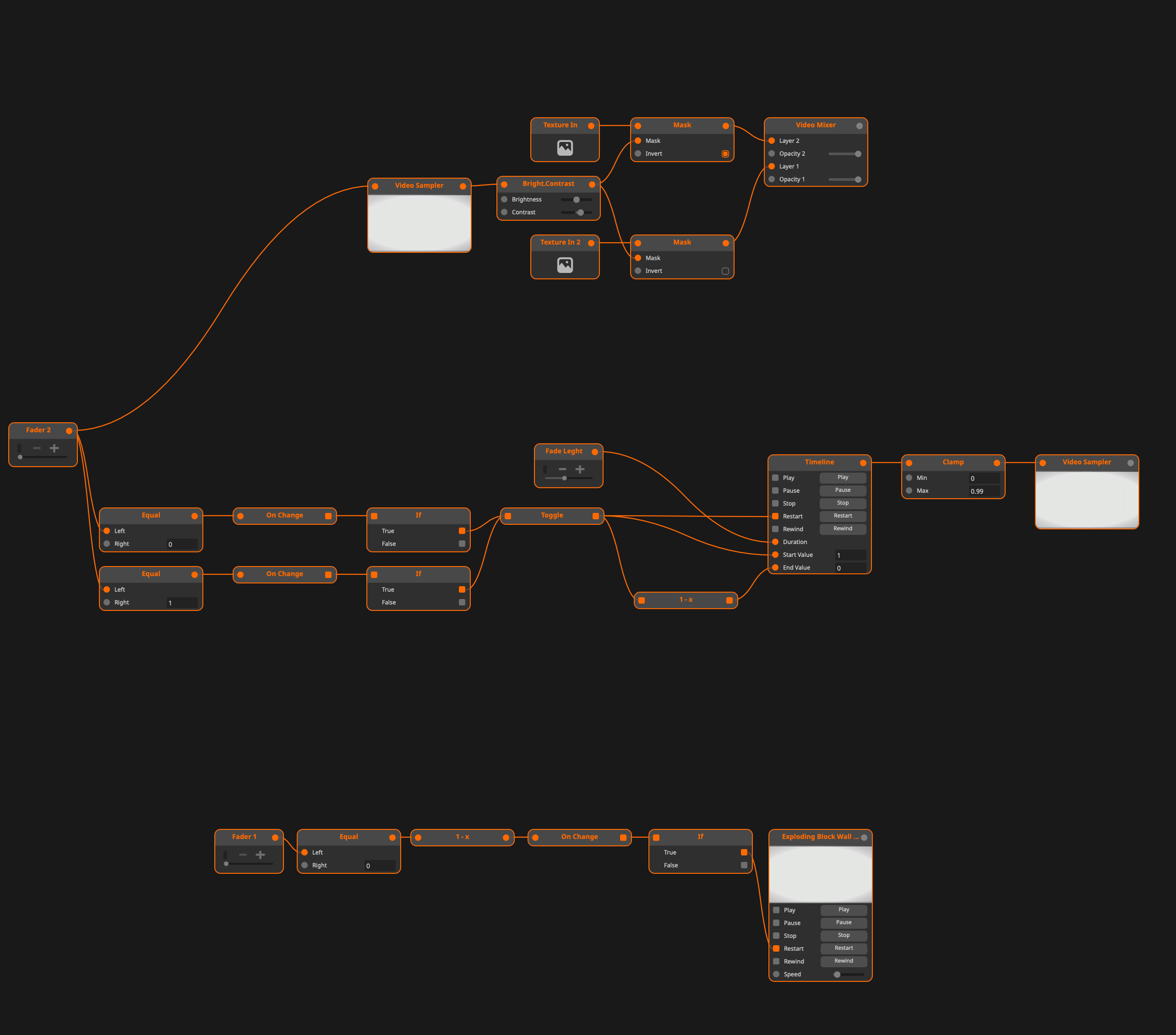

OK that's strange.... here I made it again but without any videos in it, may be that was the problem so now there are two empty video sampler's, and one empty video player, you have to put in you're own movies. If this still doesn't work, I also put in a screenshot.. It's easy to rebuild from that as well...

tijnisfijn
- Team Resolume
- Posts: 355
Re: Wire Tutorial: Checkerboard Blend Mode
The problem with the way you want it to do it, is that you can only play a movie forwards in the video player so if you want to have the same transition but the other way around you're gonna need to put in two movies. The second movie would be the first one but playing in reverse. which is more intensive on the processor. One way around this would be to have a invert on your movie, but that's cheating it cause it will change black to white and white to black but it won't reverse your movie. If you understand what I mean....
