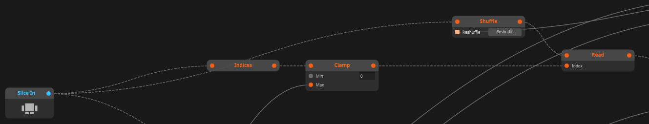

Hey there,
I am using a slice input with the 4x4 dummy.
I would like to pick for example 8 random slices out of the 16 slices and turn them magenta.
I am fiddling around here the last hours an cannot find a way to do it. I could hardwire it.... but that's not usable for me :)
any idea :?:
Best wishes
Posts: 7781
Re: wire: Randomly pick slices from slice input?
slice in-> reshuffle -> Read
--begin-wire-patch--
735.3ocuV0zaiBCD8uxJeFhrM1FH2XayJ0K6gtGqxAWvIwZI1Qfoenp7eeGCIDXaZK8C0DIR7n23Y77diGdBkaMFUtSaM0n427DZUkcK7Gb.x13103PKCPNKXgD3w5jZipBsbePOTxQn3drTO1xxt8cD3nmClEfzlNKC.xN6tpMEpG.bfIisPAo7SHr+gz4pz2135LoM0NoIuag6wcJzbjoY6sPlGftSV1.FHh86CP2ZaLEsv1nzq23PySfvbutvsAfDAkgG7PIyDbFlSiiXQw7.zin4QrjYXJgy3LBlvETNrc4kx5tLn.BYbrHMlJ3gJAYUHiliCSHTYHtHWhYpXF3kOgTU095zbb6NXy+K36c5BkE0VGsUv5UvGgDiaM0d7bGNpdR5zwrtTmqNcJuwzTVF708XounsQWTnf78lCQ2yFxs9n+Gez+wUFDfh7bdoW.EVn2pL0cpt9befwSG.hX49ARuvNr89z9SO5CGevgUk16G.qc4.X50FYI57J.dxIEPJuUADwncjdJ4kY4r3KuLjcQJKLUr3xvnnrEfXQrHSj8YY4ScdeiLc.pnYGDDoaTizsVa4ovtRVVq.nUp5MMqVUNhapzqWOrmyuu.1ZkpX.LswoFACOVjMHKN36.A2gfBNPOmd63kPe.AWuqSTw0d2z6HNIK6cZZh0ine874X0rEtSUsyVJauF9jG4arijNneaMsGg6qj61oMqeMrWq1ojto25vSEssNrHwjacXY7y15P9PsN8Ch9V6c5FU8JpbXF6nuiuZ8jD+ZkrvSNQOWeOccieP5aHb.u87ZvjldlLY9mvfgmXNSjbXvIKgNiyIQBBNIJMwOP8kEFKRWPBY+L6hvzXFMDLsfSwwYDbzmUXb3kNFU9fBv6le90w5F6SSPu6KOlNsdV5x+9M++jNd5LfRRDBJAmFMfyn7TNkvdCBKKlPGNDLi7kMD7qhvtxTn8p68cisrMUcZ886+GvLodX6
--end-wire-patch--
Posts: 1627
Hey Zoltan,
oh man ...thank you very much.... The magic sauce in your patch was Float -- indices --- index .......
I was thinking all the time that "read" can only have one instance :roll:
Thanks
Posts: 7781
You can read multiple values, with a multi instance index.
Using the indices is easier for me, than setting a multi instance integers.
You could also check the Size of the Slice in, and use that as max to generate Random numbers, join those together into a single cord, and use the read. That might generate the same random numbers though.

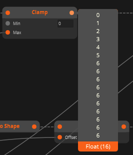

Posts: 1627
Zoltán wrote: Thu Mar 24, 2022 12:10 That I'd do with reading the max amount of slices I want to support, then render the ones which are not needed either off screen, transparent, or very small.
Reading 10 items from a smaller set like 3 (0-2) can be done two ways, with the Warp setting.
Repeat will loop back to first item at index 3, then read the second again at 4.
Clamp will read the last item repeatedly with higher indexes.
With the clamp the last instance indexes just stays at a value. So the last slice is rendered multiple times over another... for my use case that is not a problem. So no need to render them tiny or transparent. ...I guess :)
Thanks Zoltán for pointing me in the right direction.... works like a charm.
I now solved it that way....
