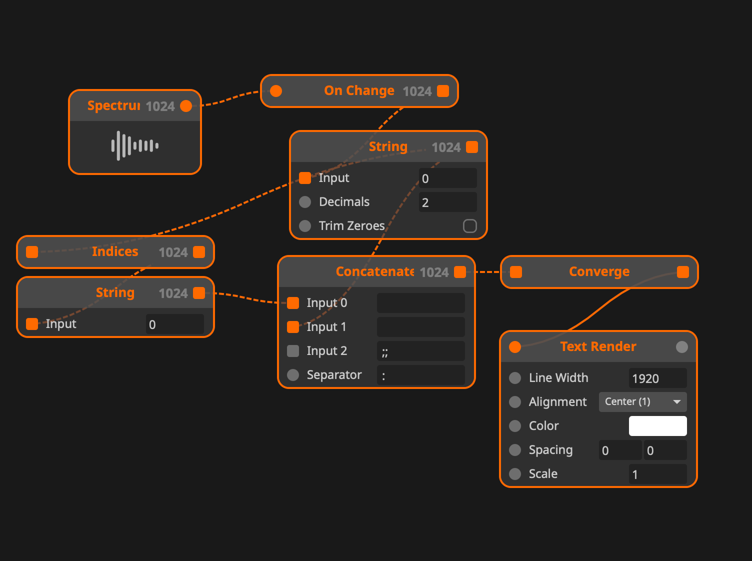

As they are just numbers, you could make a single string of the FFT values, and then use a text render to show that in the patch when loaded in Resolume.
Watch out not to create 1024 text renderers
something like this:

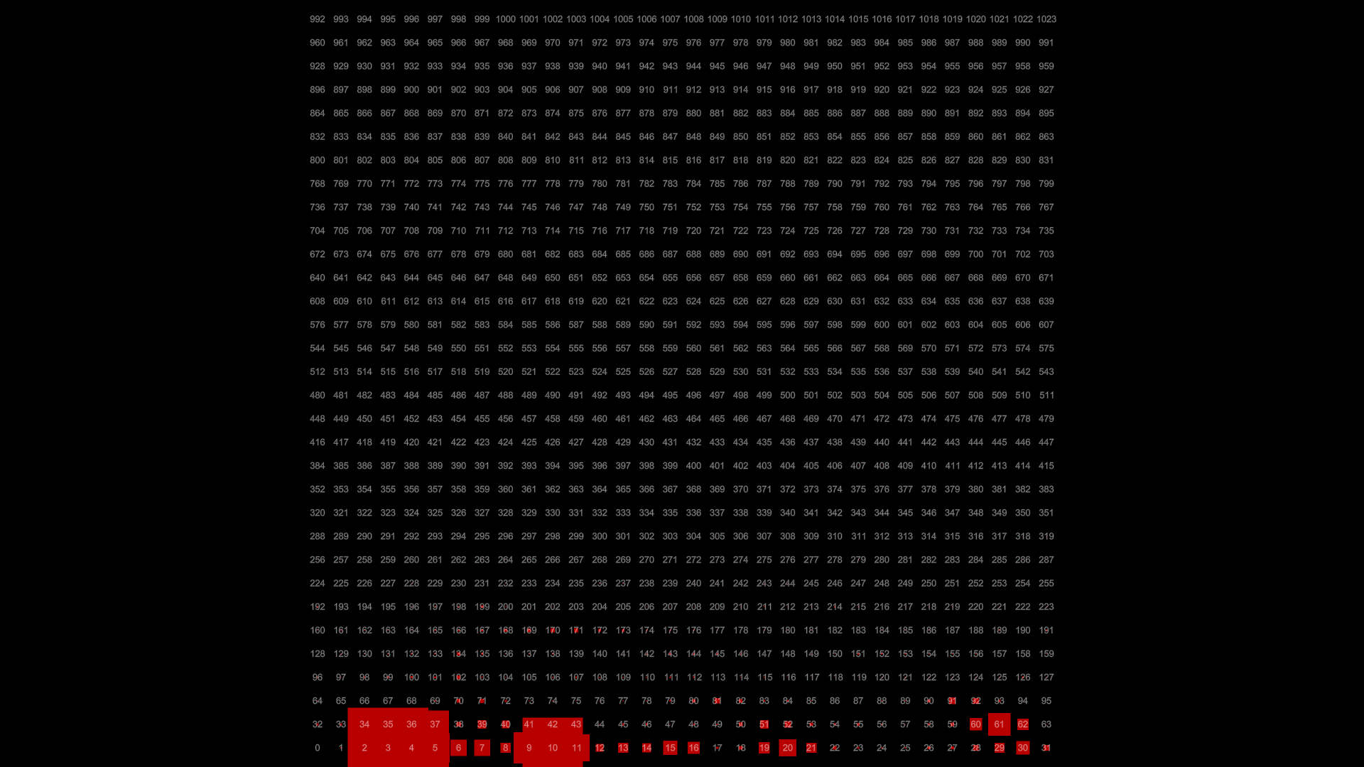

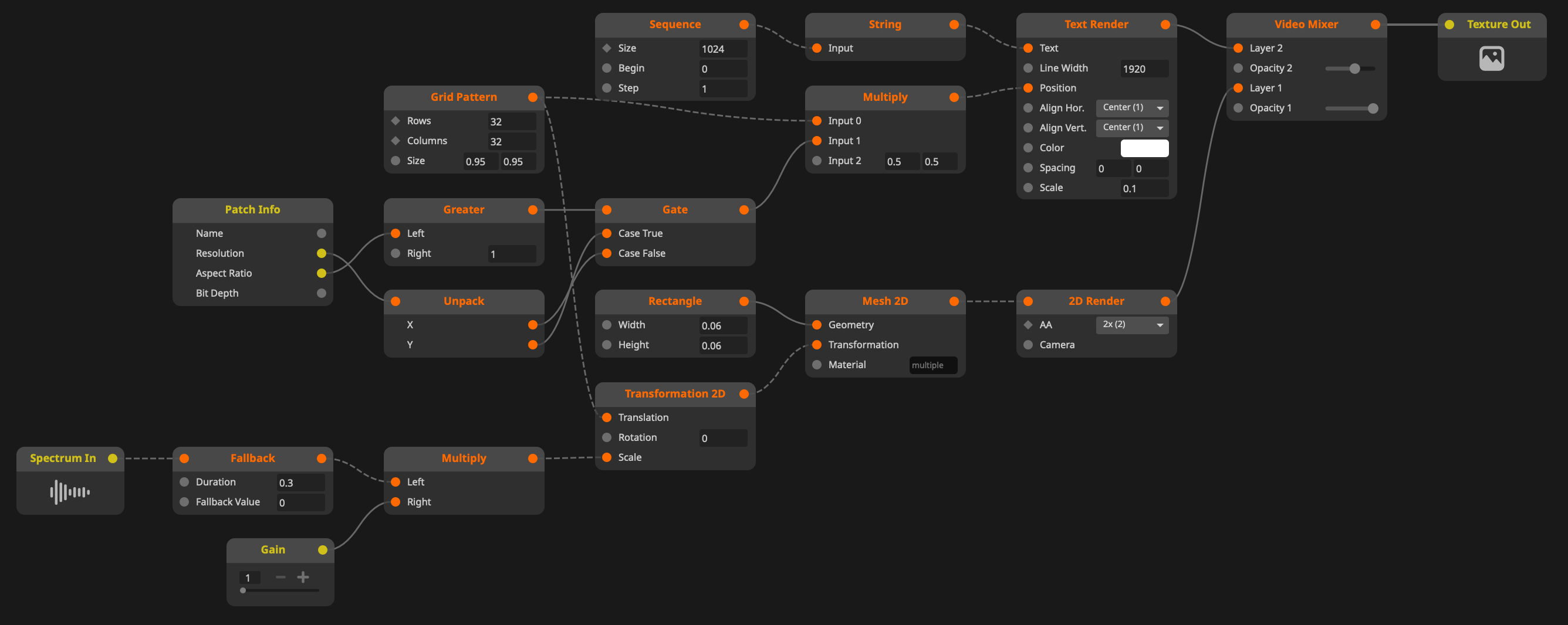

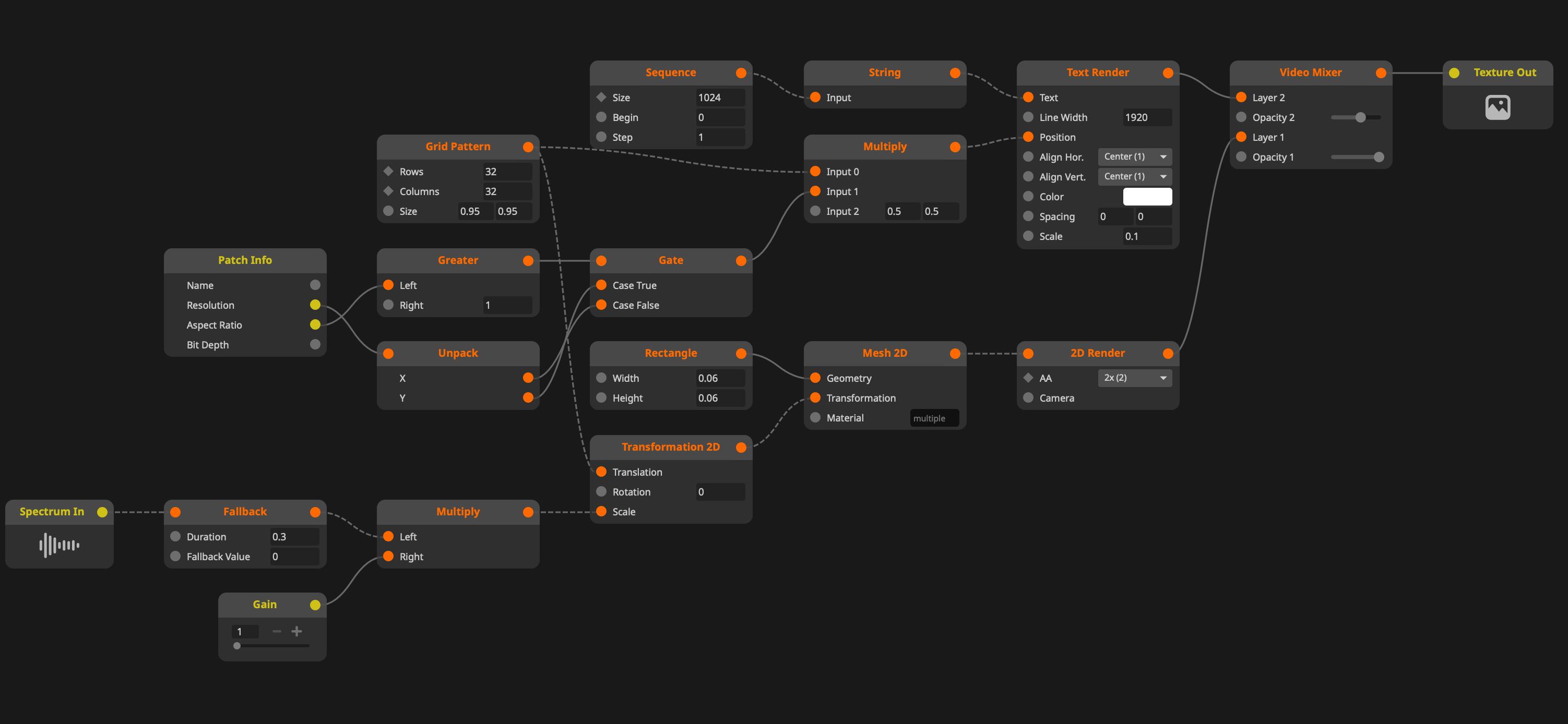

Re: Debugging FFT
Here is a little patch I made to help monitoring what comes into the spectrum in node, maybe this is useful for someone.
Just copy to your patches folder and load as a source in Arena.
