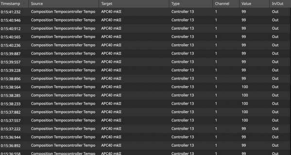

Last night I have two machine (m2 macbook pro) one primary, with pulse and ableton link enabled and secondary sending video through ndi and ableton link enabled. The “funny” thing was when pulse is correctly set the bpm to for example 120 both resolume were running the bpm at 240. As this happened to anyone else? I’ve tried different configurations, like using pulse one the secondary but not luck to have it straight. As further test I’ve just opened ableton lite on the primary machine and while it read the bpm correctly both resolumes were at the double as default. When you set the bpm /2 in resolume, everything was fine for the rest of the night. (I promise to have further test next week and report it)

Did you have OSC or midi sending between the two Resolume?

No osc, and midi sending was for the apc 40 mkii.

Seems to work fine for me, did it happen again for you?
