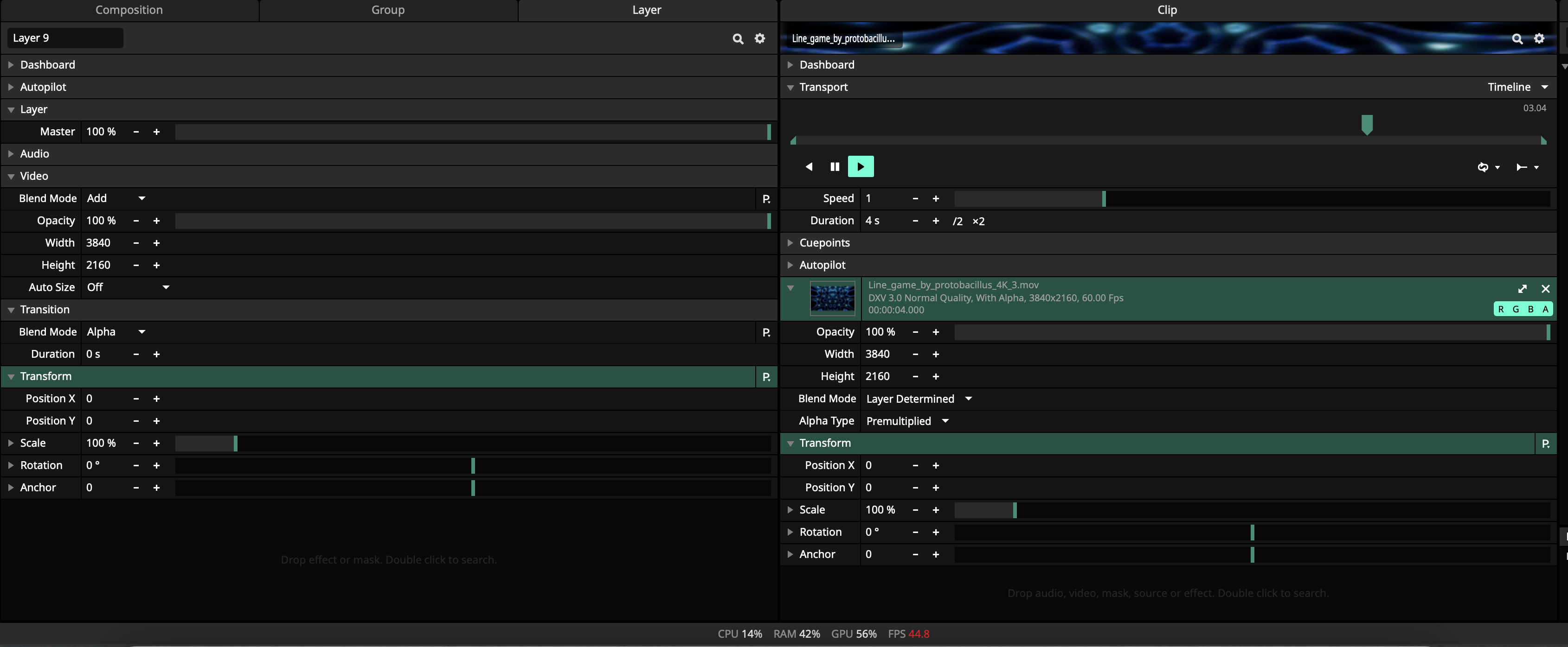

Hello,
I have a late 2023 Apple MacBook Pro M3 Max, with 96GB of memory. This beast should be more than capable of playing a DXV video file at 60fps, 4K resolution. However, in Resolume Arena 7.21.0, the best it can do is 45fps, and that uses about 55% GPU (bouncing between 41-62), according to the in-app stats. The Composition Settings is set to 60fps, and it is the only clip playing, with no Composition, Group, Layer, or Clip effects applied.
Shouldn't this beast of a machine be able to play 60fps video?
Normally I set my Composition to 30fps, but noticed that it was only doing 25fps, and using 80-90% GPU, only playing a couple of clips. I discovered that a couple of effects on my layers were dramatically increasing the GPU load, even though they were not "active", so I will re-arrange to use clips in a Group, for better performance. But with no effects on clean layers, the FPS still seems to be under-performing. Could more optimizations for Metal be made, to improve performance on this platform?

tijnisfijn wrote: Sun Jul 14, 2024 22:08 What is this something that you also had with the 7.20 version or is this just happened since you updated?
Yes, it was happening before recent upgrades as well.
I just discovered something though - restarting Resolume after changing my Composition 60 FPS enabled it to play 60fps video at 60fps. Previously, I had the Composition set to 30fps, and I had been working with a large range of content and effects for hours before changing the Composition to 60fps without restarting, and that is when it seemed to be stuck at 45fps. Now, after restarting with Composition at 60, it can play and hold 60fps for 5 layers of DXV 4K 60fps content, and starts dropping 1-2 frames at 6 layers, and at 7 layers bounces between 54 and 60 fps. Mixing in 30fps 1080p and 720p videos doesn't seem to matter much, it still plays at around 60fps.
GPU seems to bounce between 50-70% with these tests, which is much lower than how it was before at 30fps setting. I removed a number of effects from my layers that were adding a lot of GPU load.
