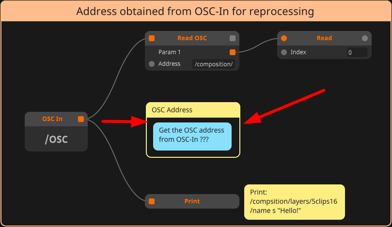

Who knows how to get the OSC address variable from resolume? Address, not parameter.
Which node should be used ?
Wire get OSC address ?
Re: Wire get OSC address ?
Ideally, having the address as a string output node would help in parsing, rather than feed strings.
I want wire to check if string contains substring '/clips/ and '/connected' to give map out grids showcasing where clips are loaded position wise. there isn't a wild card on 'address' so you have to supply string instances of address, which takes more time to build. Option proposed gives more dynamic approach and let the flow dictate what happens
moving to feature requests
Just seeing this, made my day! had to build address listeners with string concats. above update would give me a new path and reduce my node count
