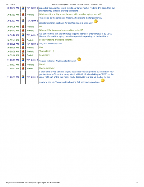

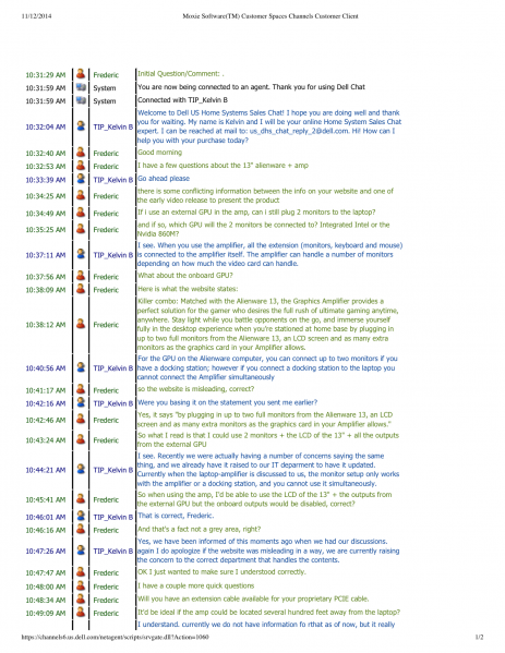

Hey Cosmowe, take a look at the attached chat with Dell to know what's what.

If this is the case, then you basically couldn't use this for Resolume unless you brought a second control monitor and disabled the laptops display, since Res does all its rendering on the GPU that's powering the interface display.cosmowe wrote:Hey Oaktown,
as far I understand the given information ...the internal gtx will be switched of if you plug in the graphic extension. The notebook screen will then be fired with an std. intel graphic chip.
