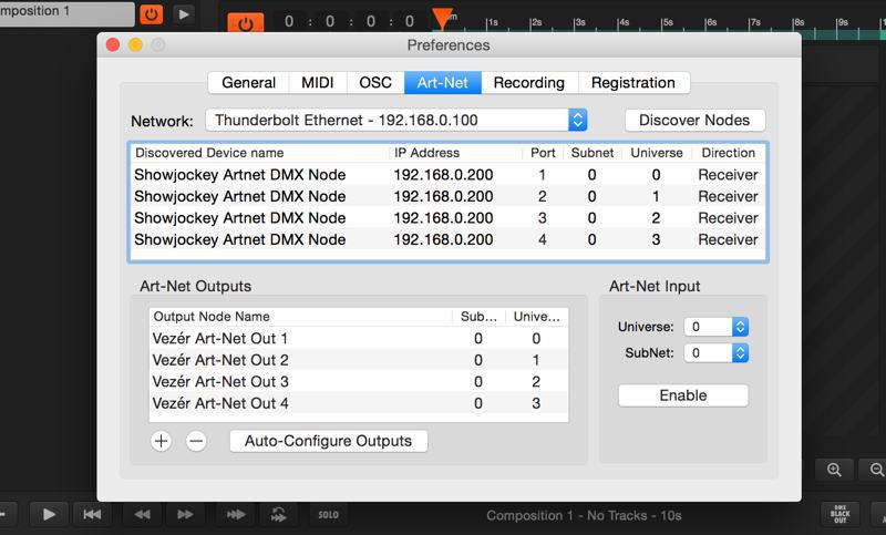

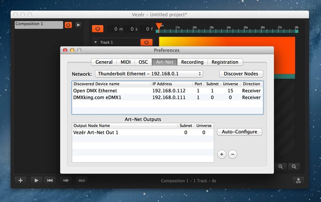

So I think it a good idea to show the user the devices we've found on the network. This is how I handle this in Vezér (its a bit different since it allows sending only to a specific network adapter, but it broadcast as well as Resolume):
  • User selects the Network interface
  • Print out any devices we found there, with IP address, Port direction, SubNet/Universe Settings
  • There is a button to automatically create outputs for all found destination universes
+1 thing which is very important with broadcasting: you are sending to everyone on the network, yes, but the received messages will be really processed on the nodes which are on the same universe address of the message. In other words, even when you broadcast, you only broadcast to (unknown, but somehow) specific devices, because having multiple nodes on the same universe does not make too much sense.
