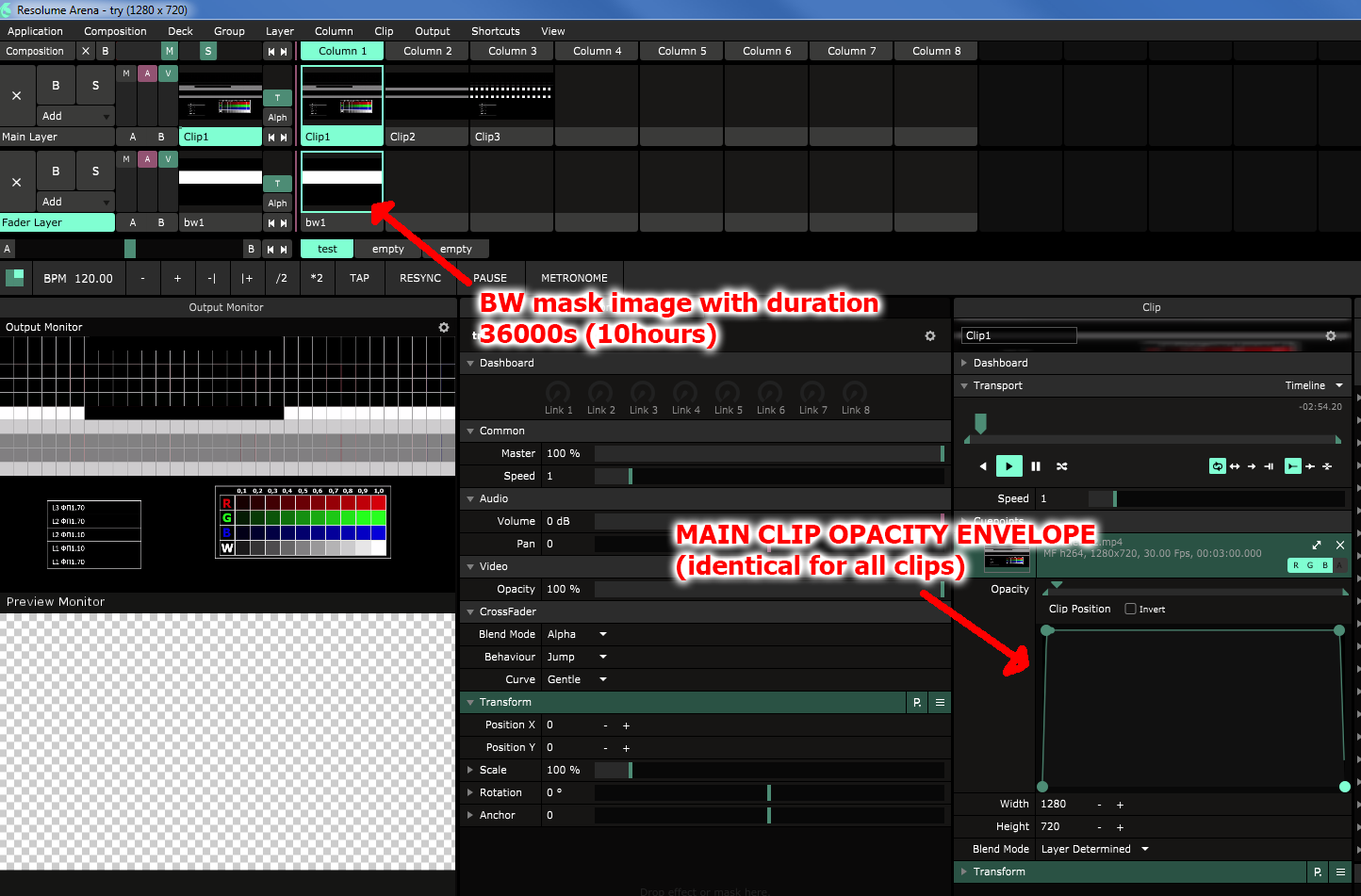

I think i done the job.
Look at the picture.
I still have 2 layers
1st - with my clips
2nd - fader level
My settings are following
- all main clips has opacity envelope (see the picture)
- the only clip on fader level has duration 10h
So i have smooth fadein\fadeout between my clips during autopilot behavior.
BUT I STILL HAVE A QUESTION.
How control envelope more precisely?
For now i set envelope timing very approximately. I mean there is no "clip time" on horizontal axe of envelope.
So, if i want to set EXACTLY "first 5 seconds" and "last 5 seconds", how to do it? Maybe there is some numerical input, or bigger window?
