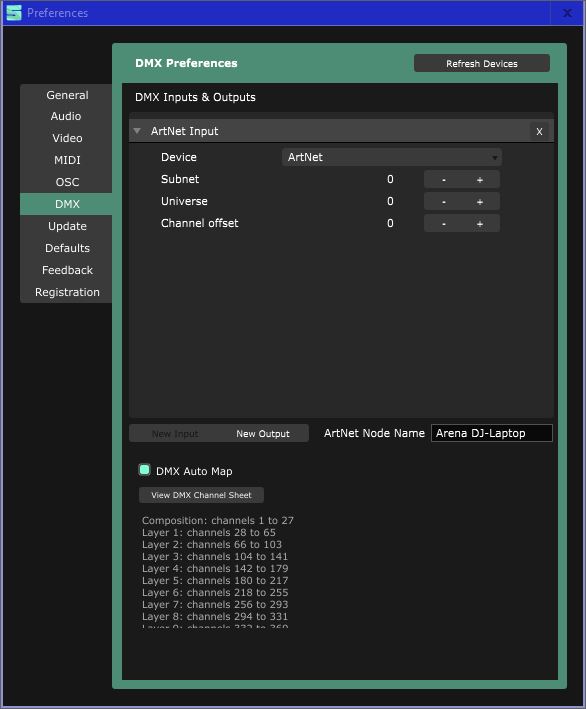

Joris wrote:The default values that Arena uses for input Universe and Subnet are the first available Universe and Subnet.
If you have no other Art-Net outputs running out of Resolume, this will be Universe = 0 and Subnet = 0.
Hi Joris, I don't have my gig laptop with me right now but I am trying to plan set up. ShowExpress does not have a Universe "0". Thoughts?

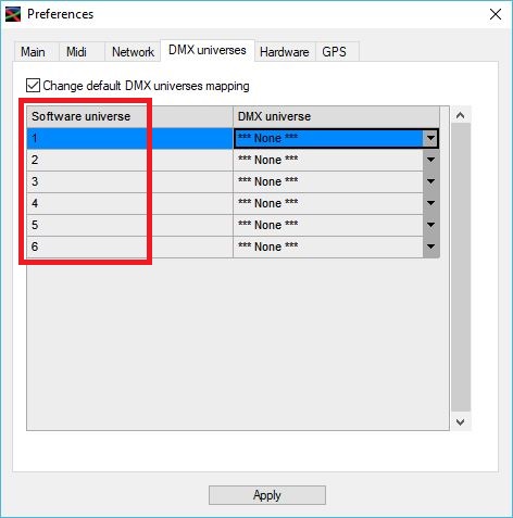

I don't know the program, but isn't the software universe 1 the first universe coming from the software?
then on the right side you should be able to select the DMX - artnet universe you want to map/send it to.
At least the dialog looks like this.

On second look, you may be right. The way SX works is you have to have 1 DMX interface (any of 3) to get 1 DMX universe and that also unlocks 1 Artnet Universe (1024 chan total).
I was thinking those drop downs were to route a universe # to the correct interface. Meaning if Resolume likes Universe 0 or possibly 1, then I would route #1 to my Ethernet adapter. Then route Universe #2, to my D512 DMX box. I will test tonight when I get off work. Just trying to knock this out on my breaks.

Odd thing is, that universe page still shows "**Nothing**" with my interface connected and multiple universes enabled. It also just remaps the default universe mapping. So maybe I can make universe 1 into 2 or vice versa. Either way, I want to do it right the first time without remapping. Which brings me to the next..
The other issue, once all your fixtures are in universe 1, you have to wipe the universe 1 to then add them to universe 2. Then re import your scenes, which gives you an error. So you have to manually select the fixtures that you moved to universe 2. Not impossible, but very clunky. I will feed that back to them, but they are working on their next major version. So new features are going to be far off.

My real question is what do the numbers in the Resolume config mean? 0 (zero) is not an option for a Universe in SX and Subnet is not an option at all in SX. Here are my Resolume settings. I have tried setting numbers here, 1s and 0s in each, all and combinations.

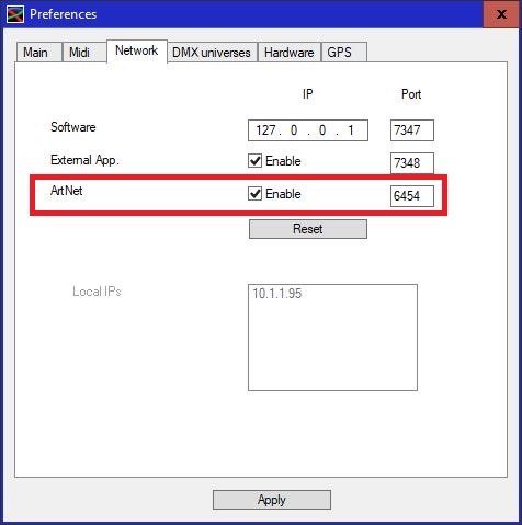

Here are some of the ShowExpress options. Artnet is enabled and I restarted SX.
SX Art Net enabled.JPG (43.75 KiB) Viewed 13343 times

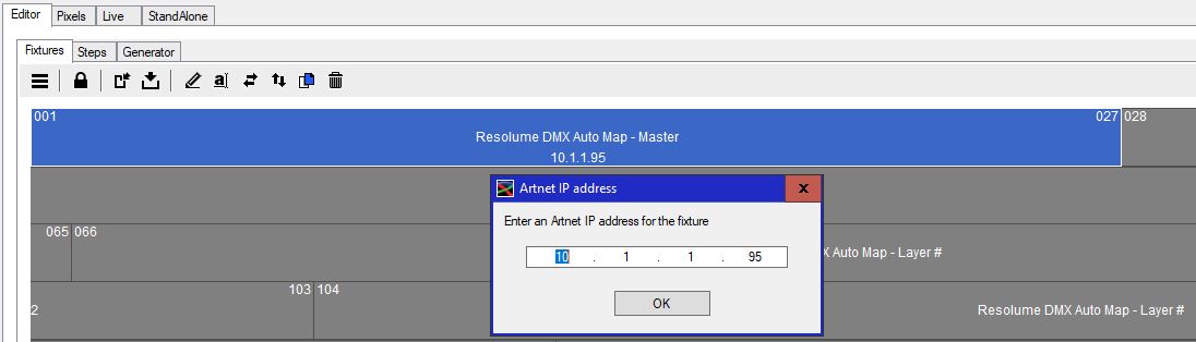

Here is my fixture "Mater" Resolume fixture. I tried both 127.0.0.1 & 10.1.1.95

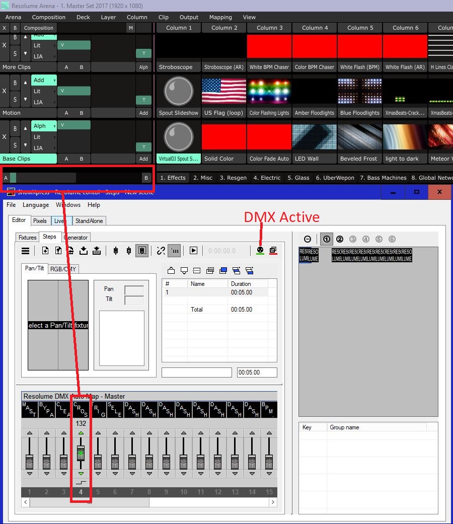

No control with DMX active. Note the Universe numbers right at the end of the "DMX Active" label. No "0" option, only 1. The Circle to the left of "1" is "..." and selects all fixtures in all universes to show below in that window.
