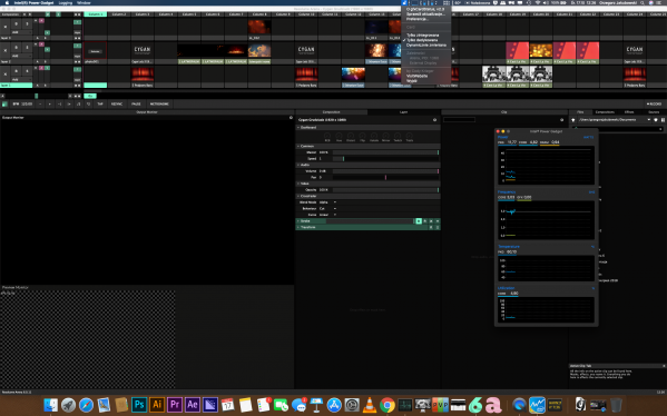

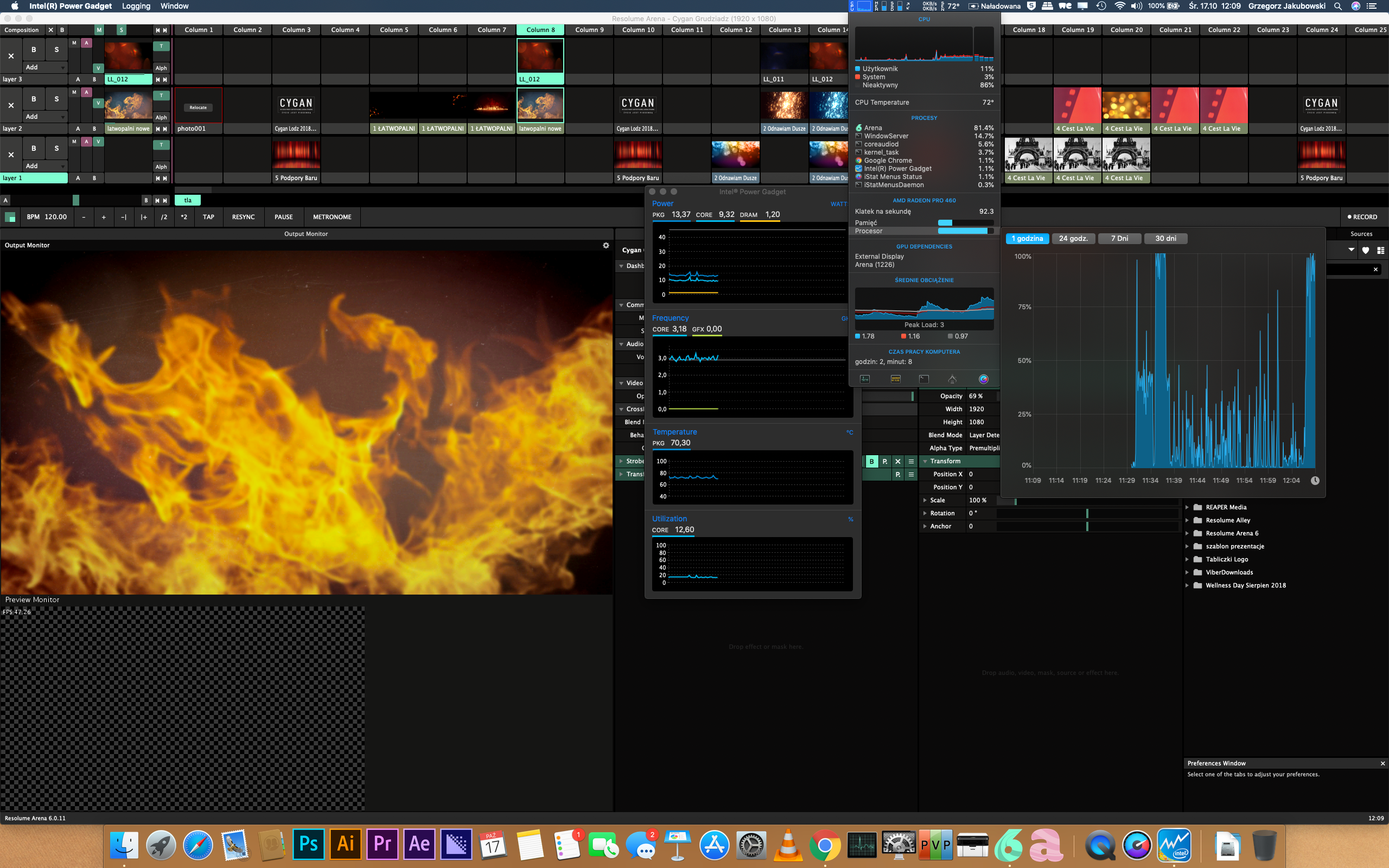

So, on recorind there are jumps between 35 and 60 with fps on black and also on 2 layers 1080p.
GFX jump from 0 beacouse of recorind, when its just resolume it show 0, but other app i-stats show that GPU is working on 100%.
GPU swtiching is off from the begining.
Here is recording in better quality for You:
https://youtu.be/k8wPuIkmNBg
So still no help ;/

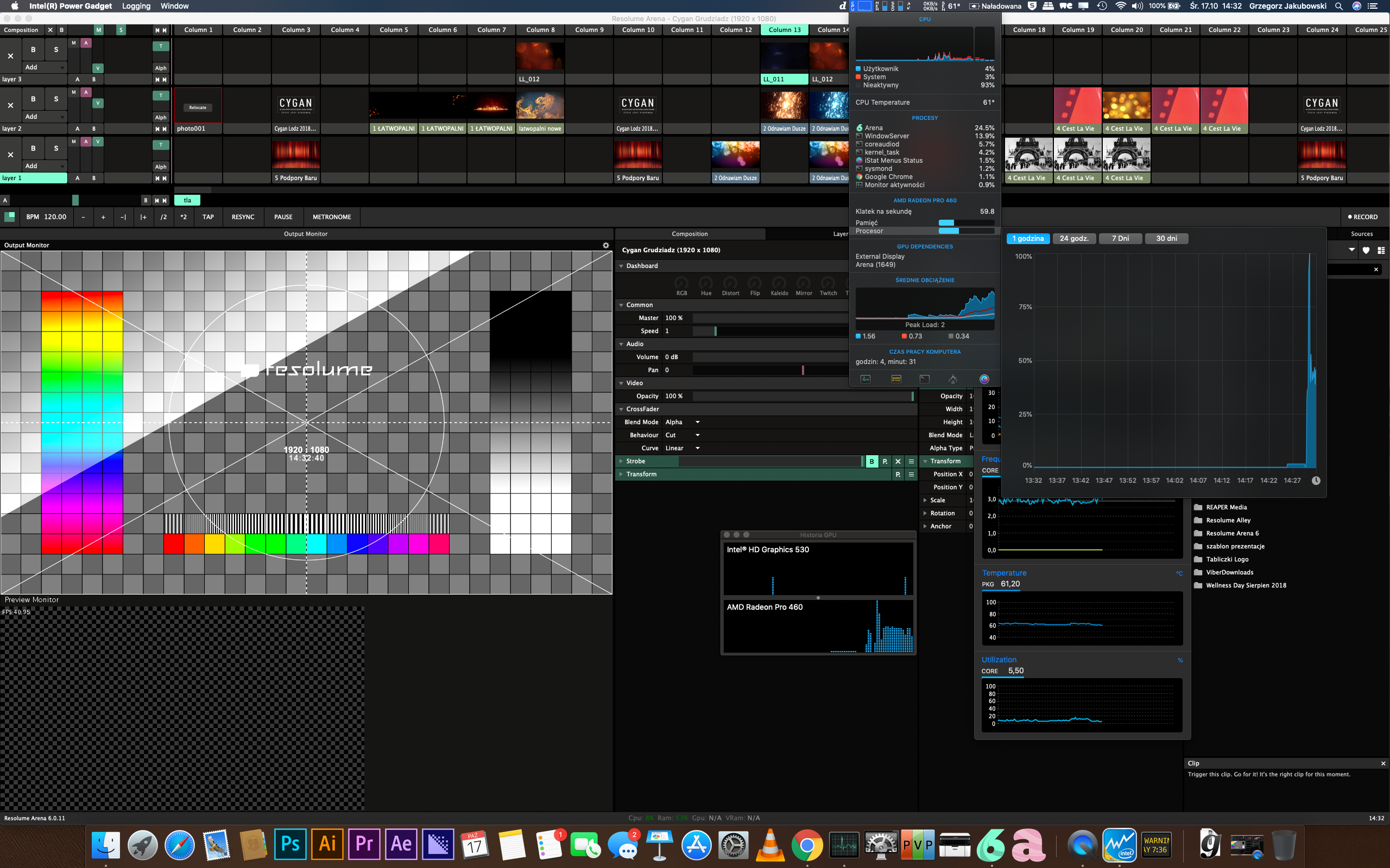

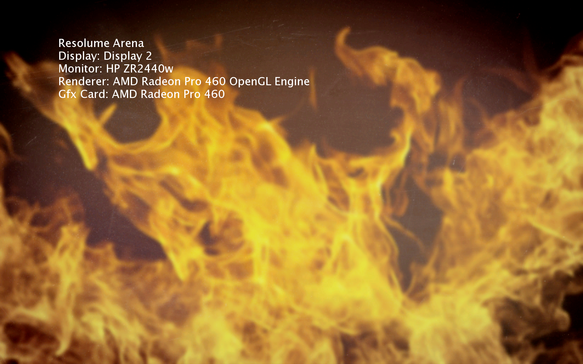

Here you can see witch GPU is used
And what i can see that istats menu show that gpu is working on 100% and then REZ is going on 60FPS, but when fps goes down to 35-55 GPU also goes down....

Re: Resolume 6.1 on Mojave .. Problem!
Could you check this with GFXCardStatus?
You can also force the use of your dedicated gpu with it.
2Vision
Posts: 18
Joined: Mon Oct 15, 2018 11:25
Post by 2Vision »
The same...

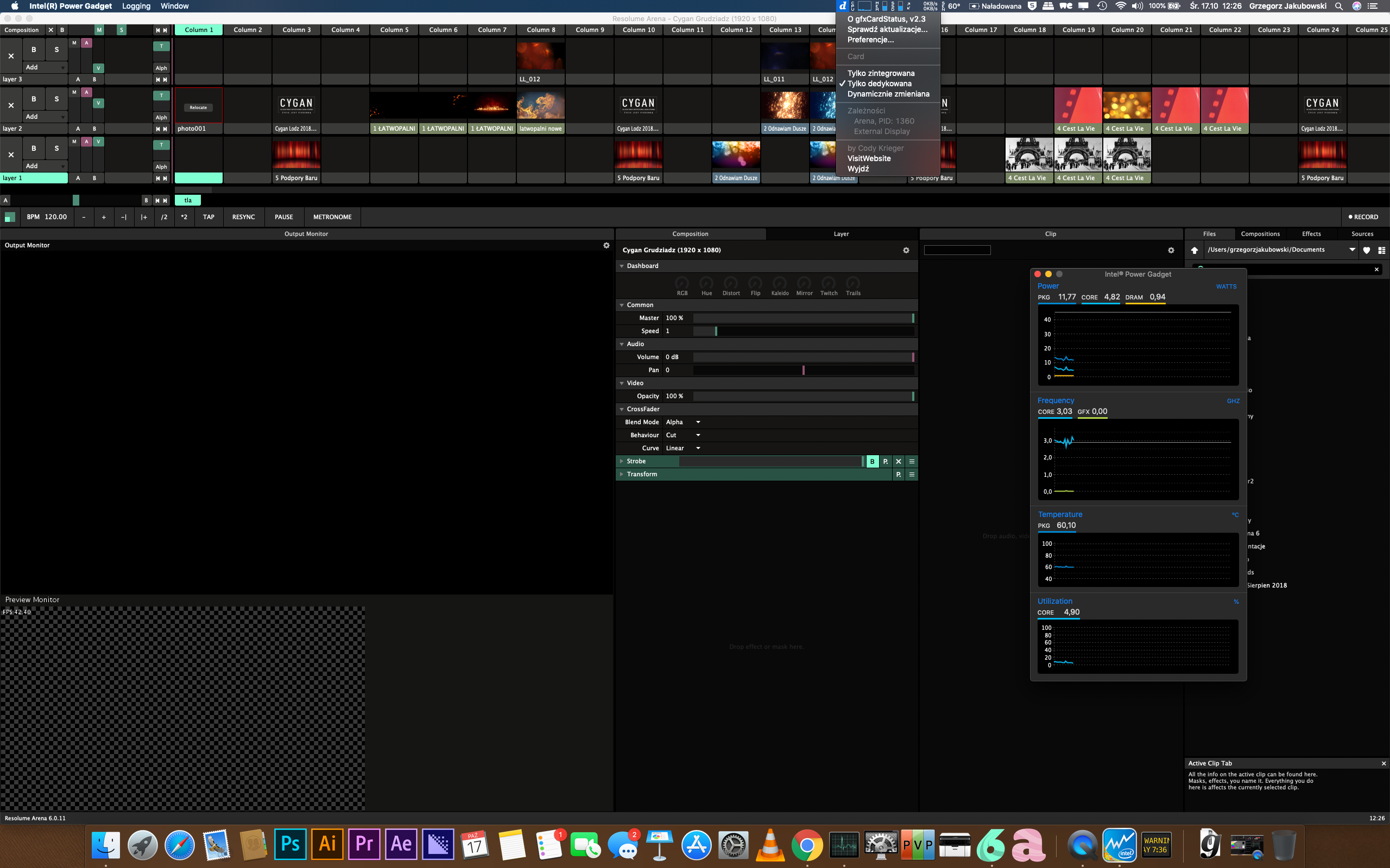

Posts: 7651
That's odd.
In Resolume Preferences - Video, you'll see a DMA Textures switch, try switching it to Force On.
Does that improve things?
Could you also try with the OSX graphics switching option enabled?

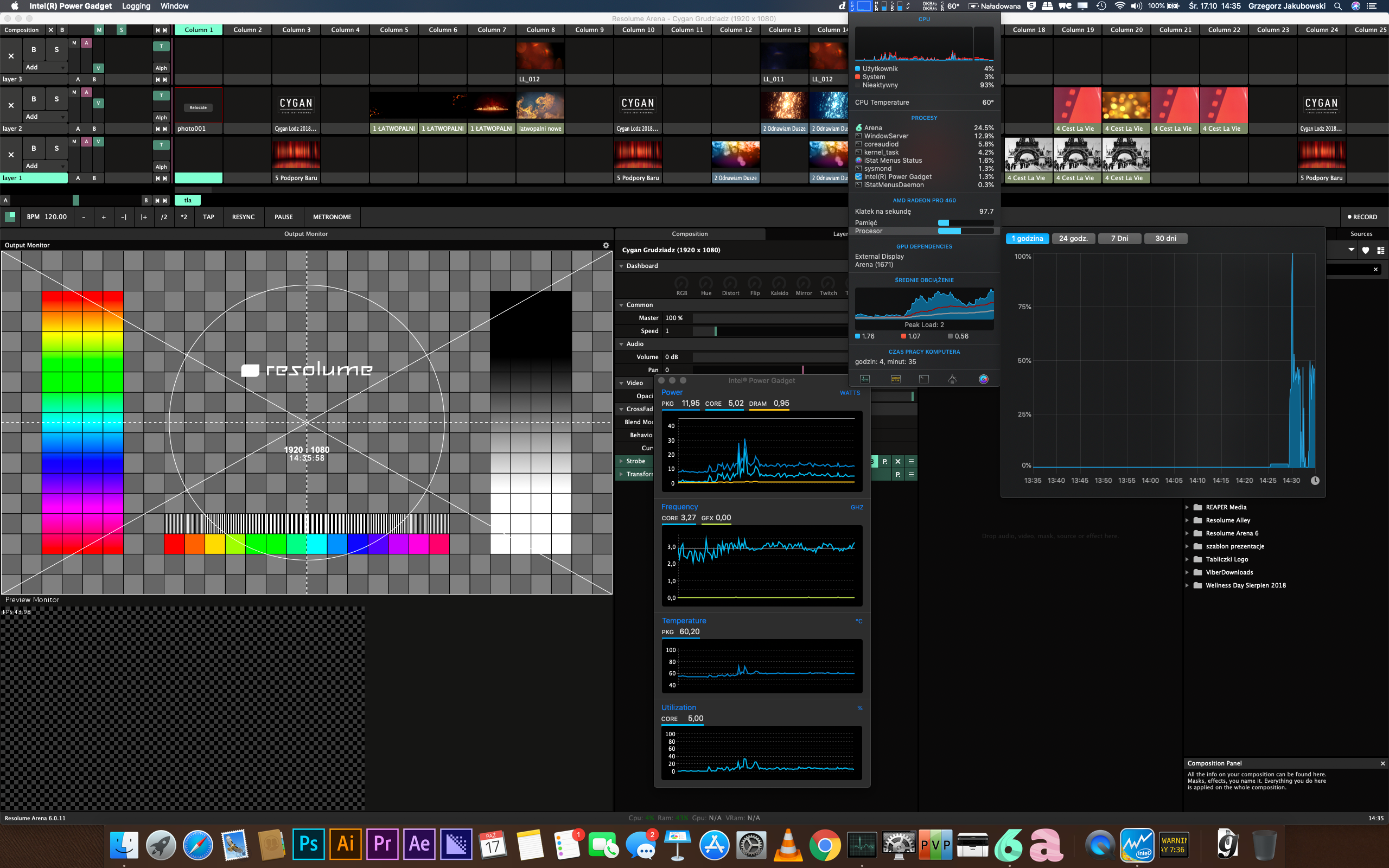

2Vision
Posts: 18
Post by 2Vision »
Didnt help...
And when chrome is off the same:
You can read proces are running

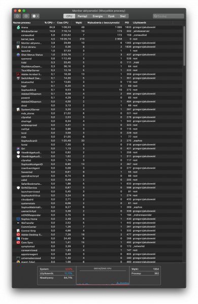

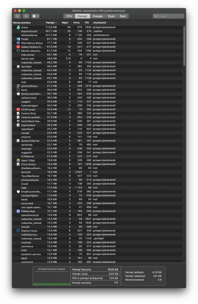

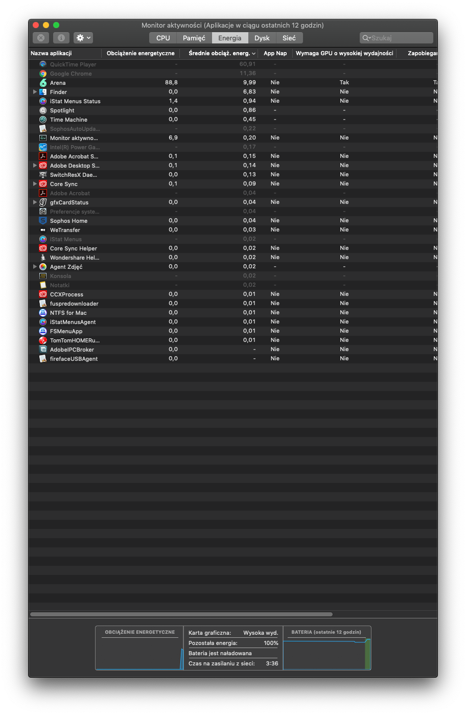

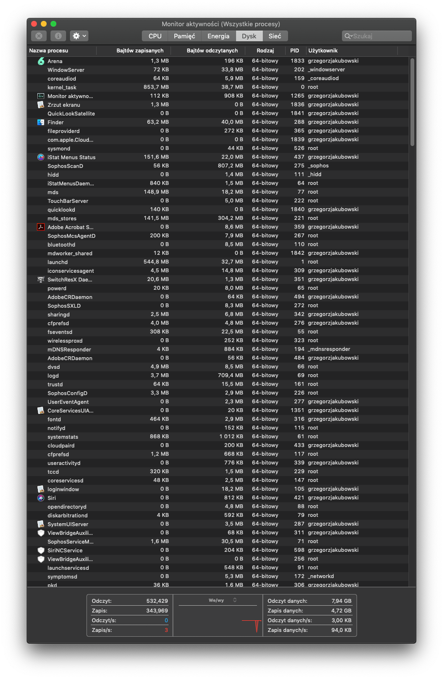

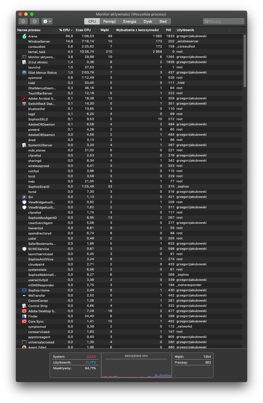

Can you take a snapshot of your activity monitor for both CPU and Memory?

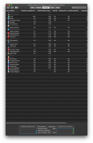

2Vision
Posts: 18
Post by 2Vision »
Here
