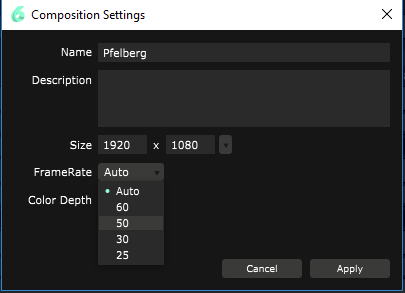

sure you can try a driver update.
What's about your framerate comp settings? Are they set correctly?

Hi Cosmowe,
Frist of all, thank you for your attention and pacience.
Driver was already updated.
I did try all settings in Composition Panel Settings. Auto, 60, and 30. Unless there's a need to restart Resolume after changing this setting, nothing really changed or made the desired results on FPS.

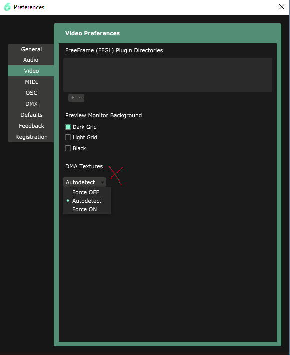

Another thread reminded me :)
Also do some testing with the DMA Textures:
Greetings

cosmowe wrote: Tue Jul 09, 2019 19:15 Another thread reminded me :)
Greetings
I think I've done that also. Thoug I thought that was for Mac only. I am allways set to auto. I will disable that as well.
